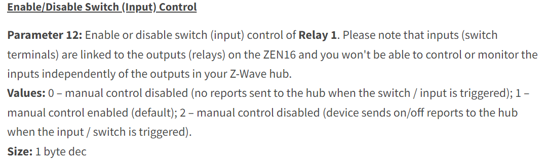

Just received my new zen16 device and got it installed. I noted on the advanced settings page that the 3 switches can each be set as follows:

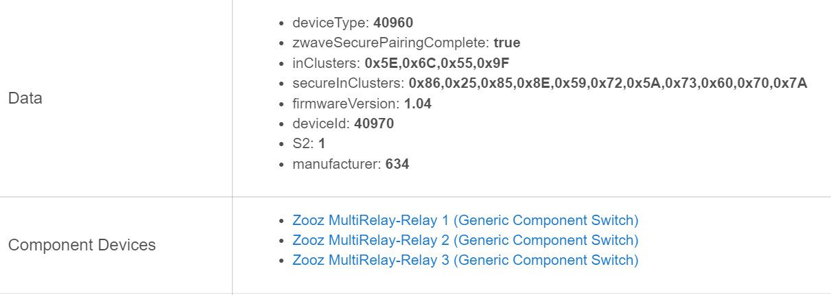

I got the zen16 paired with my hubitat just fine - it asked to go ahead with S2 security, I allowed it, and it appears to be paired fine with 3 child devices:
My intended use is to use my old home security door sensors as switches and not use the relays. It seems like setting parameter 12, 13, and 14 to value 2 should do the trick, but my hubitat settings page doesn't have parameter 2 in the drop down:

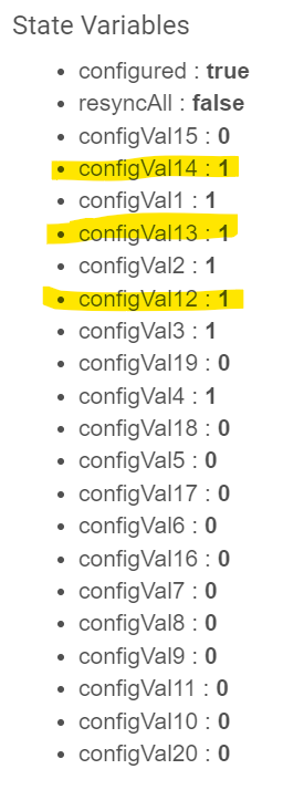

If I'm thinking about this correctly, no selection = blank value, disabled = 0, enabled (default) = 1. This seems to be corroborated by the state variables:
