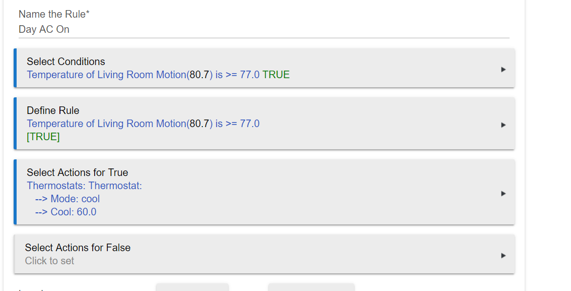

I have a rule to control my thermostat that is not working with the new release. It should just turn the thermostat to cool and set the temp to 60 degrees. It was working on 2.09
app:11642019-05-22 19:48:44.868 errorgroovy.lang.MissingMethodException: No signature of method: java.lang.Double.getAt() is applicable for argument types: (java.lang.Integer) values: [0] Possible solutions: getAt(java.lang.String), next(), putAt(java.lang.String, java.lang.Object), wait(), grep(), getClass() (selectActionsTrue)

dev:14222019-05-22 19:48:15.997 errorgroovy.lang.MissingMethodException: No signature of method: zenZigbeeThermostat.fahrenheitToCelsius() is applicable for argument types: (java.lang.String) values: [79.7thermoAdjCoolTrue.1] (setCoolingSetpoint)
dev:14222019-05-22 19:48:15.885 errorgroovy.lang.MissingMethodException: No signature of method: zenZigbeeThermostat.fahrenheitToCelsius() is applicable for argument types: (org.codehaus.groovy.runtime.GStringImpl) values: [thermoSetCoolTrue.1] (setCoolingSetpoint)
dev:14222019-05-22 19:48:15.748 errorgroovy.lang.MissingMethodException: No signature of method: zenZigbeeThermostat.fahrenheitToCelsius() is applicable for argument types: (java.lang.String) values: [55.4thermoAdjHeatTrue.1] (setHeatingSetpoint)

Can you still operate the thermostat from the driver?
yes I can
When I clicked on the rule and tried to adjust the Action for True it would give me an error telling me to check the logs. I recreated the rule and I can go in it now but still throws the errors
Is that a custom driver?
no the built in Zen Driver
If you substitute the zen for a virtual thermostat (just to test) do you still get an error?
yes I do
Ok. Tagging @bravenel for this one. Be patient, he’s got a lot of irons in the fire right now.
I will investigate. Have a pretty good idea what's wrong, and can fix for hot fix release.
good man sir......
It's what I thought it was. Fix is in.... Release pending.....

Bug in RM setting thermostat fixed and released in hot fix.
