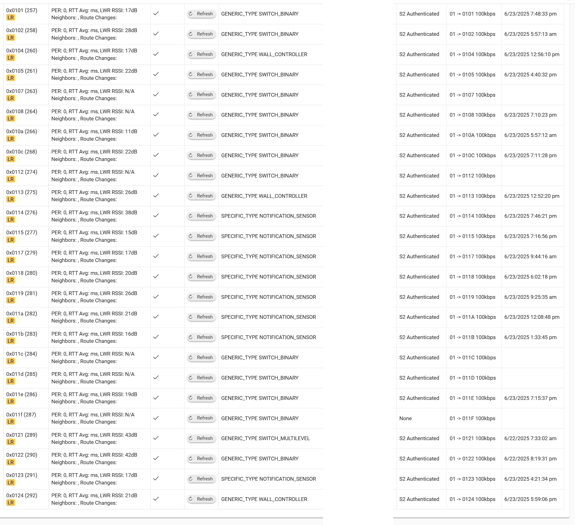

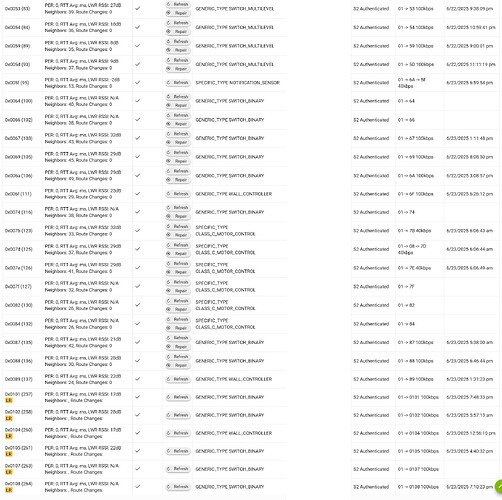

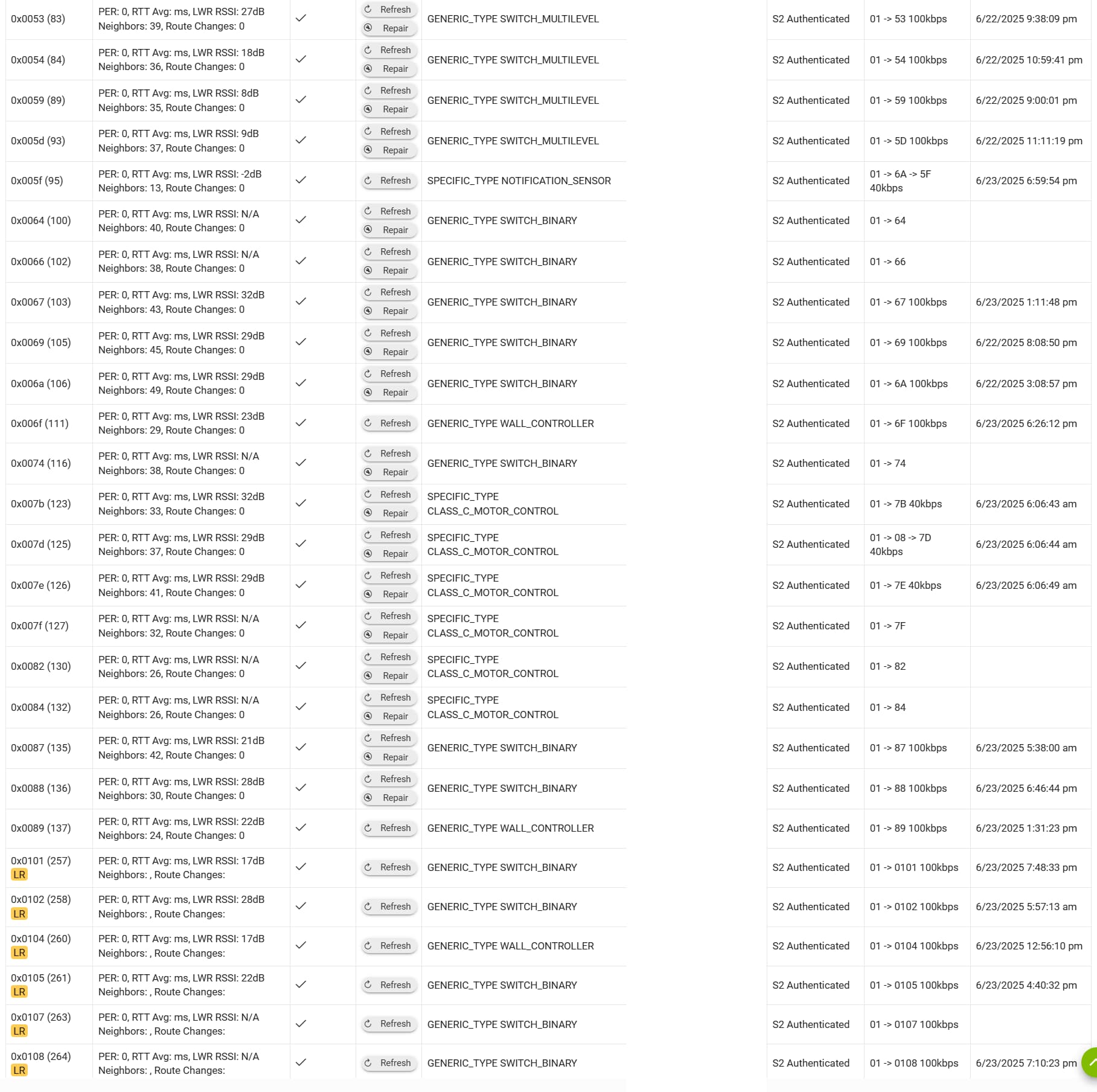

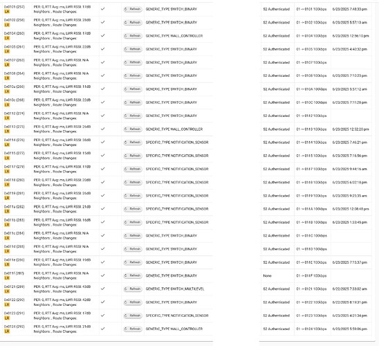

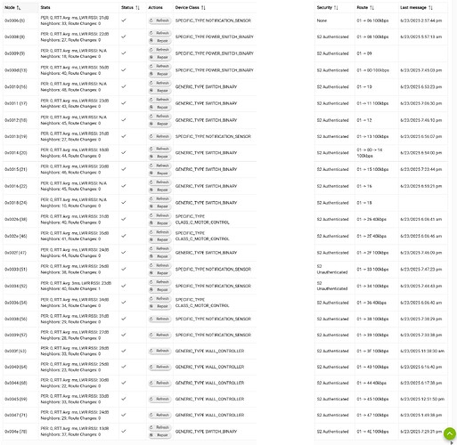

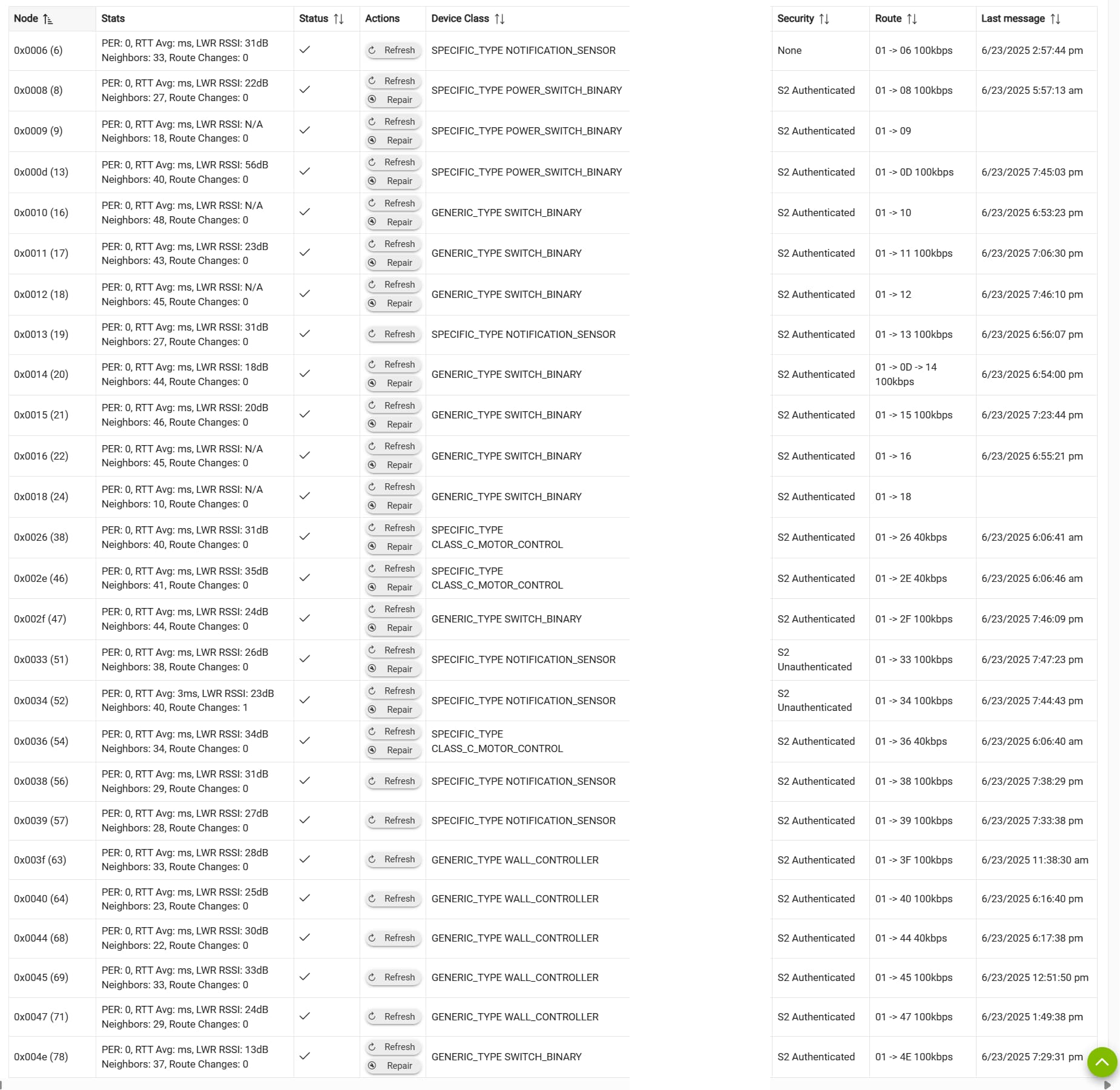

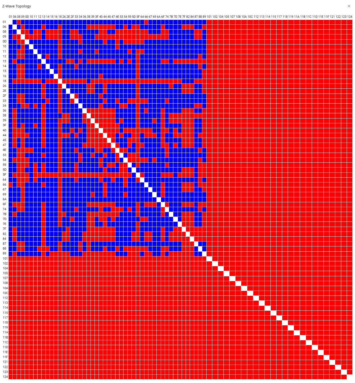

Below are the Z-Wave details. Note those devices that have not responded are disabled.
Thank you for taking the time to review this issue.
It does not look like the stats are refreshed. No RTT and route changes are all 0. May not tell us anything useful though.
All those devices are active? You hid the device names so it’s impossible to tell on the ones with no messages.
Don’t have any other advice but that info is good for staff to see to help understand what the issue might be.
Thanks for reviewing the data. Yes, all of those devices are active with the exception of those with no messages that are "disabled" in the devices list.
All that does is prevent the hub from processing messages from it. So they are essentially the same a ghost/dead node like this.
Can you plug all the mesh ones in for a test (any that are mains powered)?
Not sure why it would be impacting the LR devices but for sure the mesh ones I could see the hub taking a few tries of re routing to figure things out with all those devices missing.
