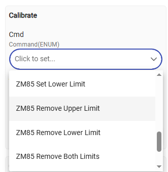

Zemismart sells a lot of Tuya-based devices - a few of them probably designed or manufactured by the company itself, but the majority are sourced from OEM manufacturers and rebranded under the Zemismart name. There are many different curtain and blind motor models with varying hardware and Tuya data-point implementations. So, setting the motor limits may work or may not work with the existing community driver. Try the "ZM85" series of commands :

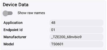

Also, please identify your device Zigbee model and manufacturer.

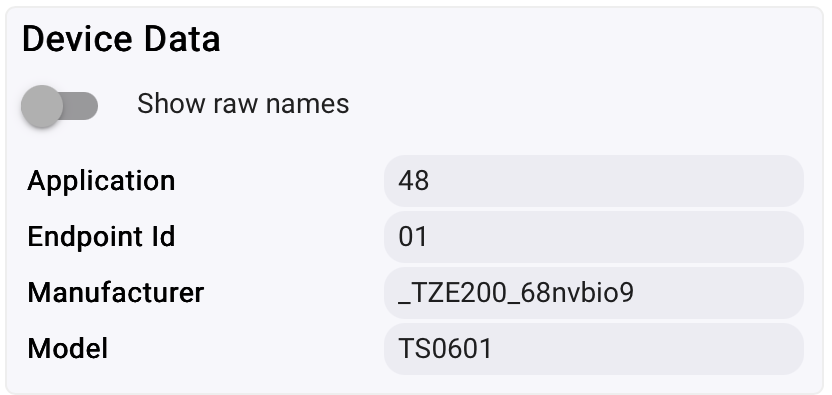

Here’s the device info:
