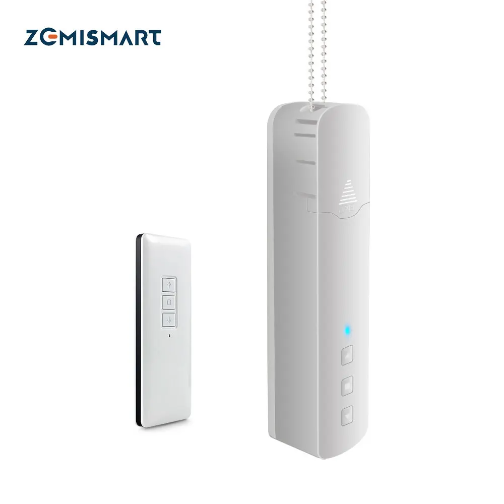

Anyone else have these? They seem to be different from the wall-powered Tuya/Zemismart roller blinds in that they come with this little "zigbee converter" thing, it doesn't seem like you connect directly to the roller motor.
I'm currently using them through Home Assistant's Tuya integration, but considering pulling my HE back out if it can connect and control them locally.

No these. The photo is misleading because it comes with a little USB dongle that seems to be the actual Zigbee device.
I've been having trouble getting the dongle to pair with HE, but haven't tried extensively. I got it to pair with HA, but it just shows up as a Zigbee router.
So hard to decipher things on AliExpress. This looks like they are including a Zigbee hub and that it is connecting to the shade. So the Zigbee radio is in the shade and the hub.
So try to pair the Shade with Hubitat and forget trying to join that hub with Hubitat as that’s not going to work.
Been chatting with @gassgs, and I think the little "hub" module is actually the only component that's zigbee, and I think it's sending RF signals to the motor. I've ordered a Sonoff RF Bridge and am going to try sending RF signals directly to the motor and bypass the little hubs.

However, can you confirm there is no pairing button on the shades themselves? In these photos, they sure do make it look like you can use their Zigbee hub to communicate directly with the shades. For them to include a mini Zigbee bridge and then suggest you add a Zigbee hub as well is odd. But it’s not out of the realm of possible scenarios. Chinese manufacturers have some very unique approaches to issues.
There is definitely a button on the motor itself too. However, as far as I can tell it's only used to set or reset limits. I tried all the usual combinations of button presses/holds to get it to pair to zigbee on HA, and couldn't.
I know the language on these instructions probably doesn't mean much, but they do specifically call the little USB dongle a "Zigbee converter". And it does specifically say you need to use a Tuya Zigbee Gateway (hub).
Seems like it may indeed be either a proprietary radio or 433MHz between the transmitter and the shades. However, sometimes I’ve found I can better interpret the meaning of the English that Google translate gives me, rather than a written In English translation from the manufacturer. Point your phone at the Chinese instructions (if included) and see what they say versus the provided translation.
