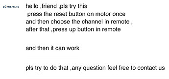

I contacted Zemismart and they provided instruction:
These didn’t work initially (I am not sure why). However, I tried them again after having removed and re-inserted the remote battery and they worked, which allowed me to set the upper and lower limits.

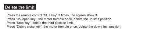

I found that I set the down limit a bit to low and was provided the following instructions to delete them. They can be executed independently of each other:
