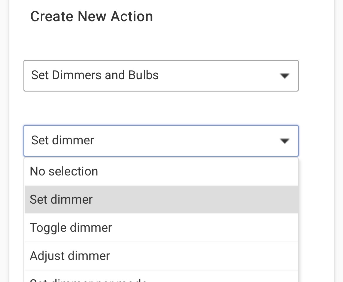

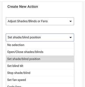

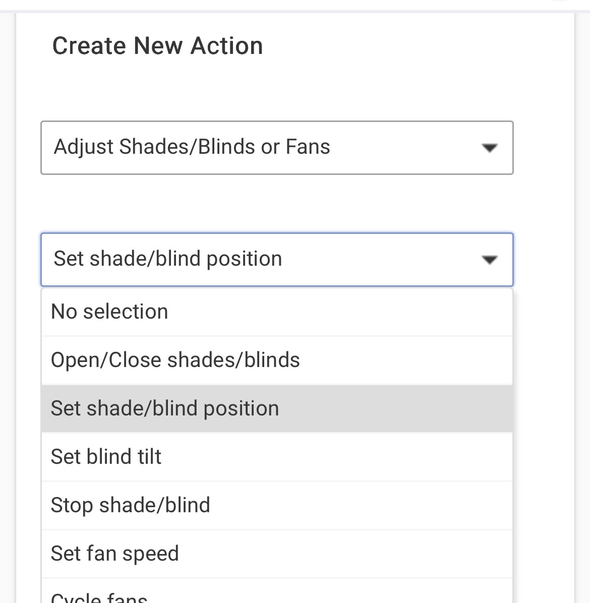

What commands does the driver you're using offer? You can find this on the "Commands" tab of the device detail page.
Depending on that, it's likely either a "Set Level" (dimmer-type behavior but found in some blinds drivers) or "Set Position" command would do it, which one of these Rule actions could do.
I use that driver for my theater shades, and I can confirm that it does use the switchLevel capability, and it has a command available for set level.
Edit: Looks like there are several drivers out there, I'm using kkossev's driver.
Thank you! Great insights that helped me find how to use partial opening. The illustrations were super.
