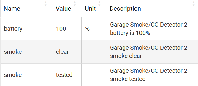

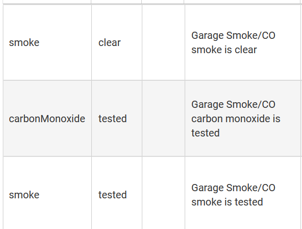

Here ya go.
Same as logs.
Plus Driver:
Non-Plus Driver:

Separate to the driver selection... From your screenshots of the Events page, that does confirm what I was thinking that no events are being recorded. As for your question / hope about others having ideas... I'm struggling, but who knows... you may find some....
