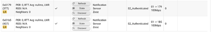

I have a C8 that has some Z-Wave issues. The issues I have with the Z-Wave ghost item and one item that fell off the Z-Wave mesh network. Looking to figure out how to clear the ghost item and get the other item back onto the network.
I think this one is an old device that died, and I couldn't get it excluded.
This sensor is good, but no longer responding.
I tried using Z-Wave JS to remove it, but it didn't offer an option to do so.

I cannot seem to clear this. Tried restoring the DB and the radio. Still cannot clear this. Any suggestions?
If you're still in js mode, simply click refresh a time or two on that line and the remove button will appear
I have tried that it still doesn't work. I have two devices as far as I can tell that fell off the network too.
disconnect power from the devices. Shut down hub and unplug for 1 full minute. Power back up and then hit refresh on those lines a couple of times to see if the remove button shows up

Post a screen shot of your Z-Wave Details page showing any remaining ghosts.
Also, I think you know this, but running Z-WaveJS long term on a C8 is not officially supported, can be too much for pre-C8-Pro hubs, so at some point you probably will most likely need to switch back to ZipGateway. Some folks have had success w/Z-WaveJS on a C8, but that's the minority.
Yeah, the ghost remains. I can't figure out how to get it undone. It's the ghost of the previous door sensor that died. I replaced it with a new one, and everything was okay, but recently I noticed a ghost and tried to remove it. There's no device attached to it, so I can't set it as a virtual device and then remove it. I feel like I'm stuck and running in circles. And JS mode. Some devices stopped responding, but I've been slowly working through them, too. I know JS is the future, I want to get there. However, I sometimes struggle with Z-Wave. This environment's been updated since c5. I'm just looking for a way to clean things up, potentially get a pro, and then move forward. I'll probably leave my C7 in place because I don't think there's much difference between the C7 and the C8 other than the chipset, which I'm not using. I'm hoping if I can get the ghost resolved fix some of the problematic devices with JS to move forward. Just so you understand what I'm trying to accomplish and get a clean database to prepare myself for the next evolution. Sorry for the long-winded message. Sometimes I feel like this is a part-time job too LOL.
