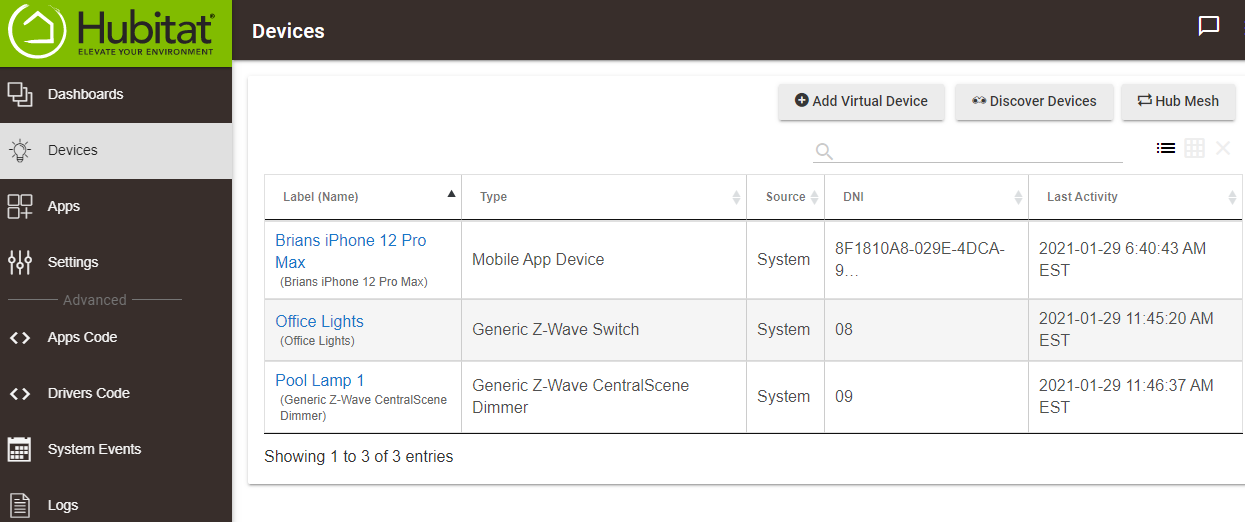

Recycling took care of my issue. I have added my first two Z-Wave devices. Woot!! Thanks for all your help!
