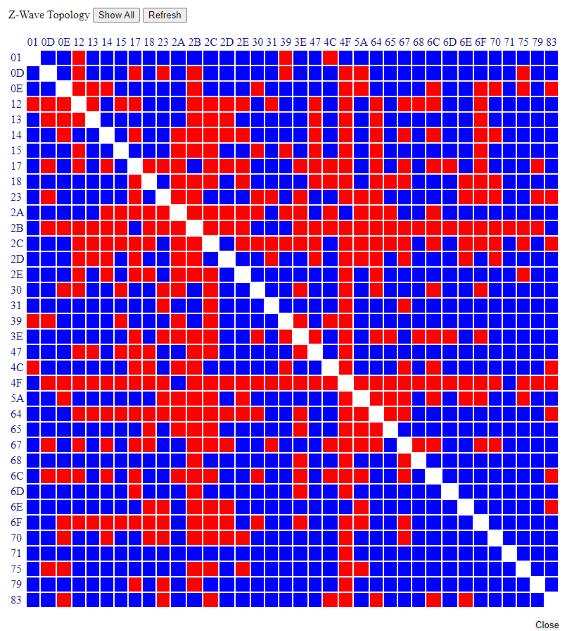

Z-Wave Topology Inaccurate on C-8?
Is the Z-Wave Topology not displaying correctly on the C-8 hub?
All my Z-Wave devices are working perfectly so far since the migration from C-7 to C-8 but the Topology doesn't appear to be displaying correctly.
I'm on the 2.3.5.101 release.
You may need to wait a few days for the mesh to fully rebuild. They purposely cleared out the routing info so it would rebuild itself with the better range and antennas.
Running a full repair may expedite it.
Here is mine (I had early access)
Gotcha, never thought of that. I'll check on it in a few days to see how it looks. I only have 8 Z-Wave currently, I use mostly Zigbee and Lutron.
Let the mesh settle for a few days. In my own experience moving to C-8, running a full repair didn't do anything, but to confirm the mesh was healthy (no failures). It took almost 3 days for the mesh to really settle.
I think I'm in your camp...I have some devices showing routing, but most still blank. Patience is a virtue, right? :wink:
ya all my devices have routes now except a few ecolink contact and water sensors that refuse to show routes in the zwave info even though they are working... ie i opened and closed the covers or opened and closed doors and they show events and are working.. but no routes for some reason..
as for the zwave topology it is utter crap and notshowing much. i belive most devices don't know what their neighbors are yet and as mentioned i assume that populates over time.
