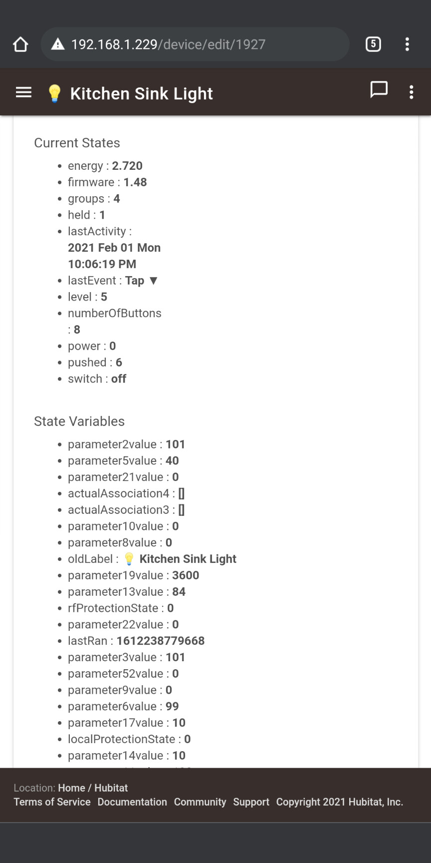

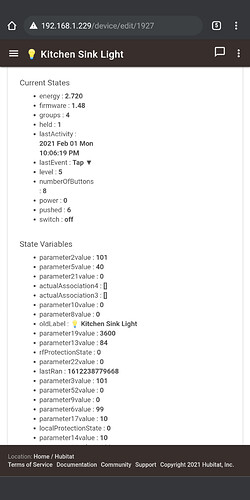

Inovelli red dimmers need to be on at least device firmware 1.48 to fix several known issues. You can get the driver version from the device page and scroll down to current states.
