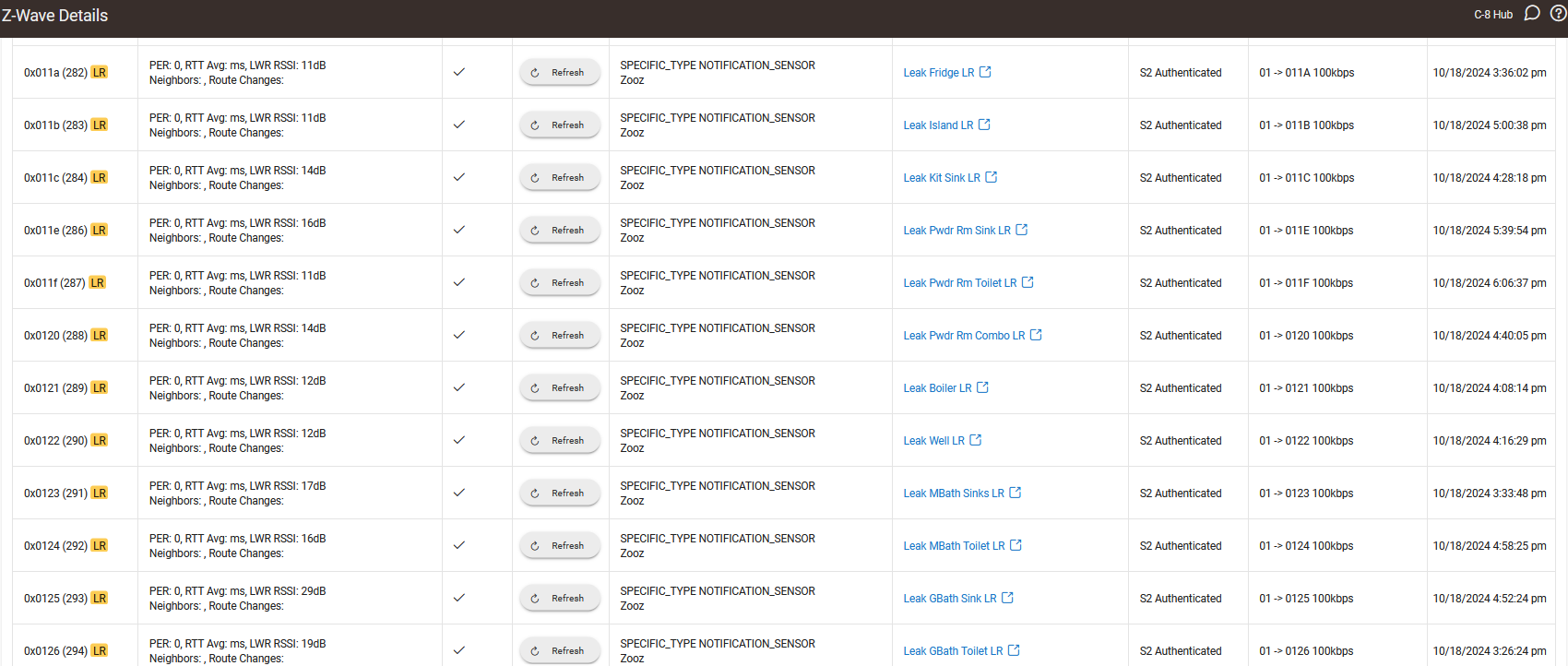

This doesn't help, or it might, but I have 12 ZSE42 LR leak sensors. Long range communicates directly to the hub, so they're all talking direct to the hub.
