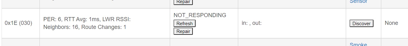

I have a rule where I have my outside lights come on at sunset. I noticed that this evening they didn't, so I started to look into it. I did a Z-Wave repair and had a couple nodes that are failed.
One switch physically failed a few days ago (I could hear the relay clicking) and I replaced it with a normal toggle switch...it's a fan that I keep on all the time anyway. It's still showing in the Z-wave details as "Not Responding" and I have a discover button. I'm not sure how to just totally get rid of it.

If you not repair a few times, maybe more, eventually you should get a remove option.
Well, after running repair four times, a remove button appeared. Now have tried to remove three times and it's still there. Maybe 4 is the magic number.
I had a GE switch fail completely a while back. I cannot get rid of the node in the z-wave list. Has anyone ever had any luck without totally resetting the radio? Does the bad node cause issues with communications with current working devices?
I have never successfully removed a (ghost) device using the "Remove" button. Only way I found was using these instructions
