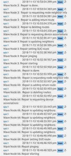

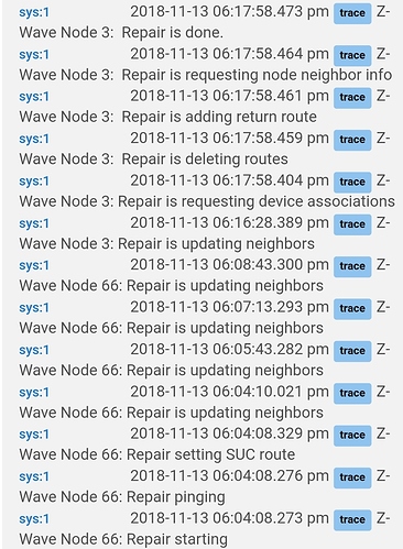

I been about a month or maybe more without doing a repair so I'm not sure if this behavior was introduced in another firmware but I did a repair after 2.0 and now I see this.
This was a normal node repair, this was the way it was doing all devices:

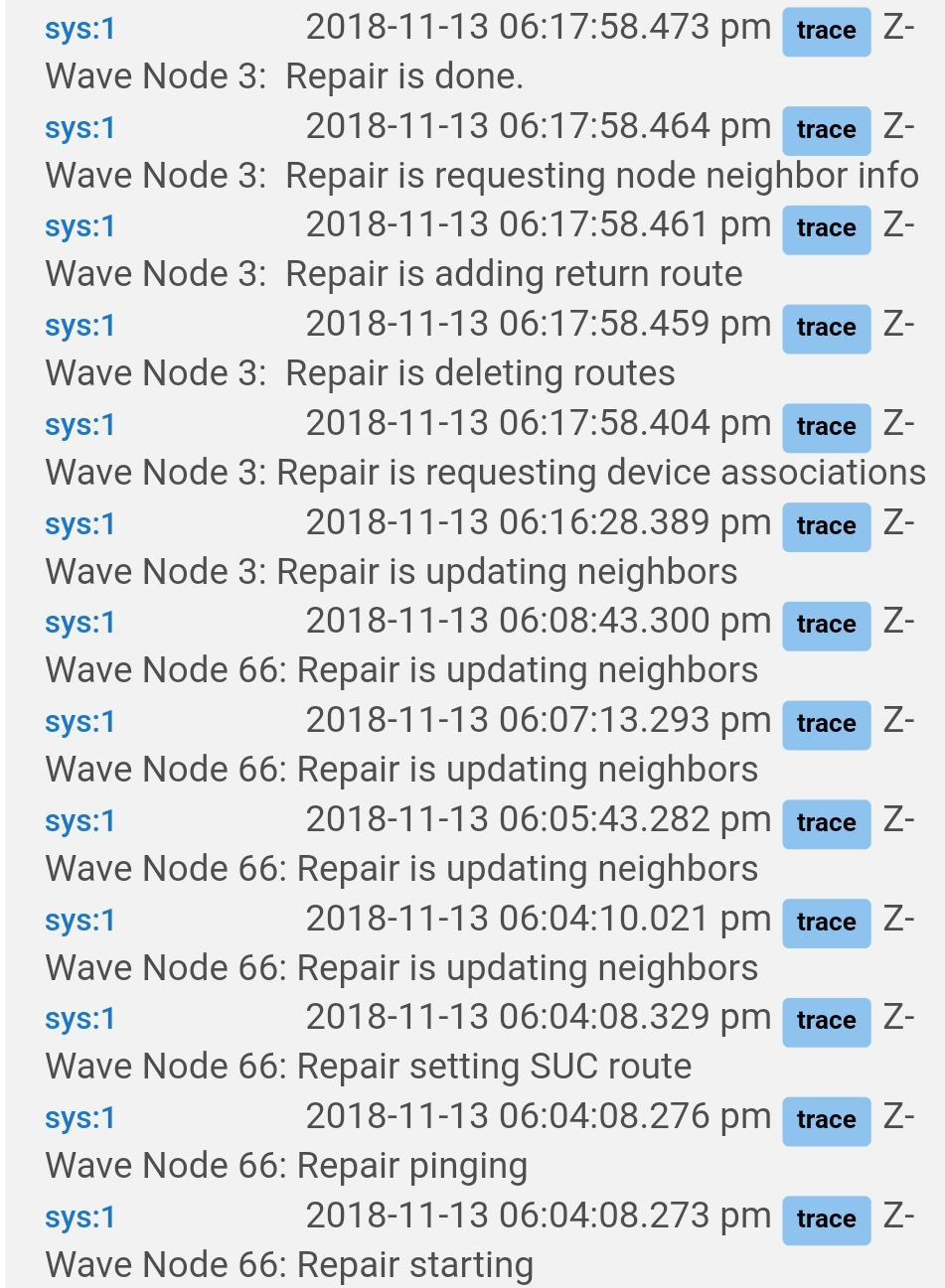

Now this is the incorrect way it's doing it (to my perspective) and multiple times in the repair with devices I had already and node was repaired fine before:
This is skipping some process, if a node fail the process, like node 66, it will skip to next node in the list but it will not start the node repair from the beginning, it starts at the last step it did with the failed node. Failed node is just my name, it's not failed at all, the node works just fine.

The node is timing out. The repair moves on. We are looking at ways to come back to timed-out nodes.
Ok, and the start of the next node at the middle of the process because the other node timed out?

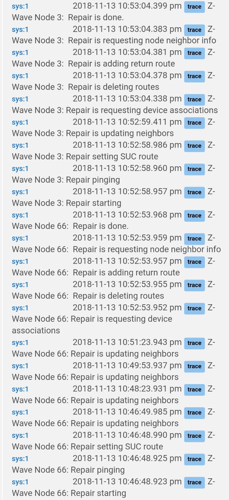

Here is the same 2 nodes (66 and 3) but they did the node repair correctly:
What I did to make them to do it correctly? I forced them to change from inactive to active turning on and off or refreshing.
