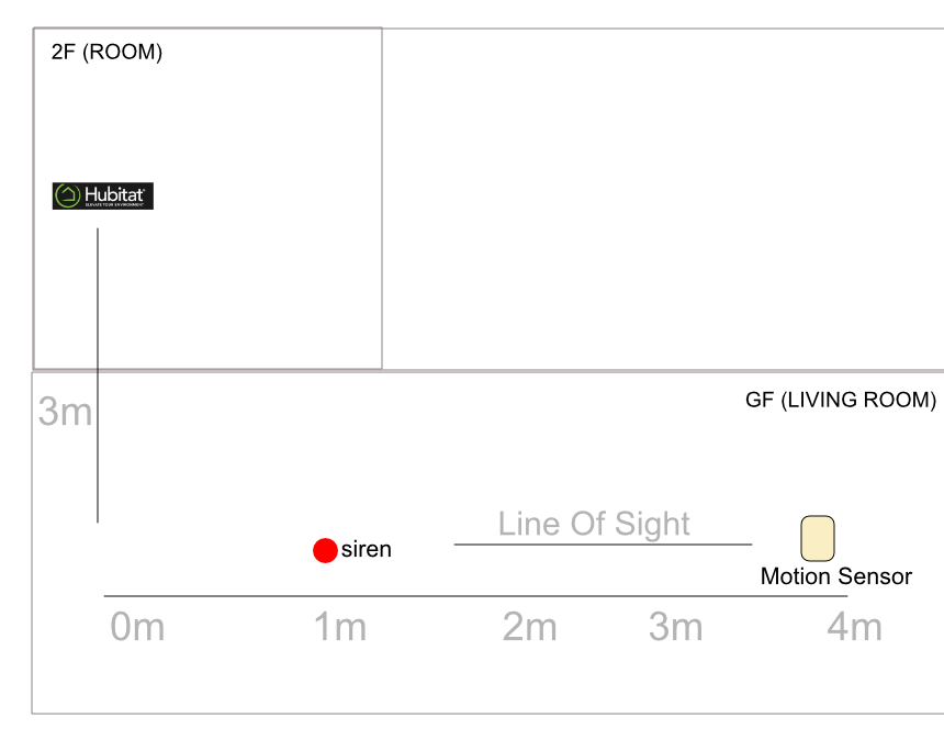

But right now i can't figure out why my hubitat (2nd floor) can't reach my motion sensor (ground floor) which I would estimate is just approx 5meters away.. (i live in a small 2storey apartment)
So i placed the siren in the middle between the hub and the sensor but it didn't improve at all.
here's how it looks like
Scenarios:
  1. Placing the motion sensor at 1m position = hubitat detects motion from it
  2. Placing the motion sensor at 2m position or farther = hubitat doesn't reach it anymore.
  3. Placed the sioren at 1m position (where it's still in range with hub) and with line of sight to the motion sensor.. = hubitat doesn't get the triggers at all.
I checked the hubitat > devices settings and made sure the mesh setting is enabled.

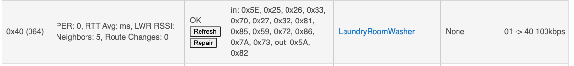

Did you review the 2nd column of the Zwave Info page?
PER and RTT and LWR are all values related to the question you asked.. or at least my interpretation of your question :slight_smile:

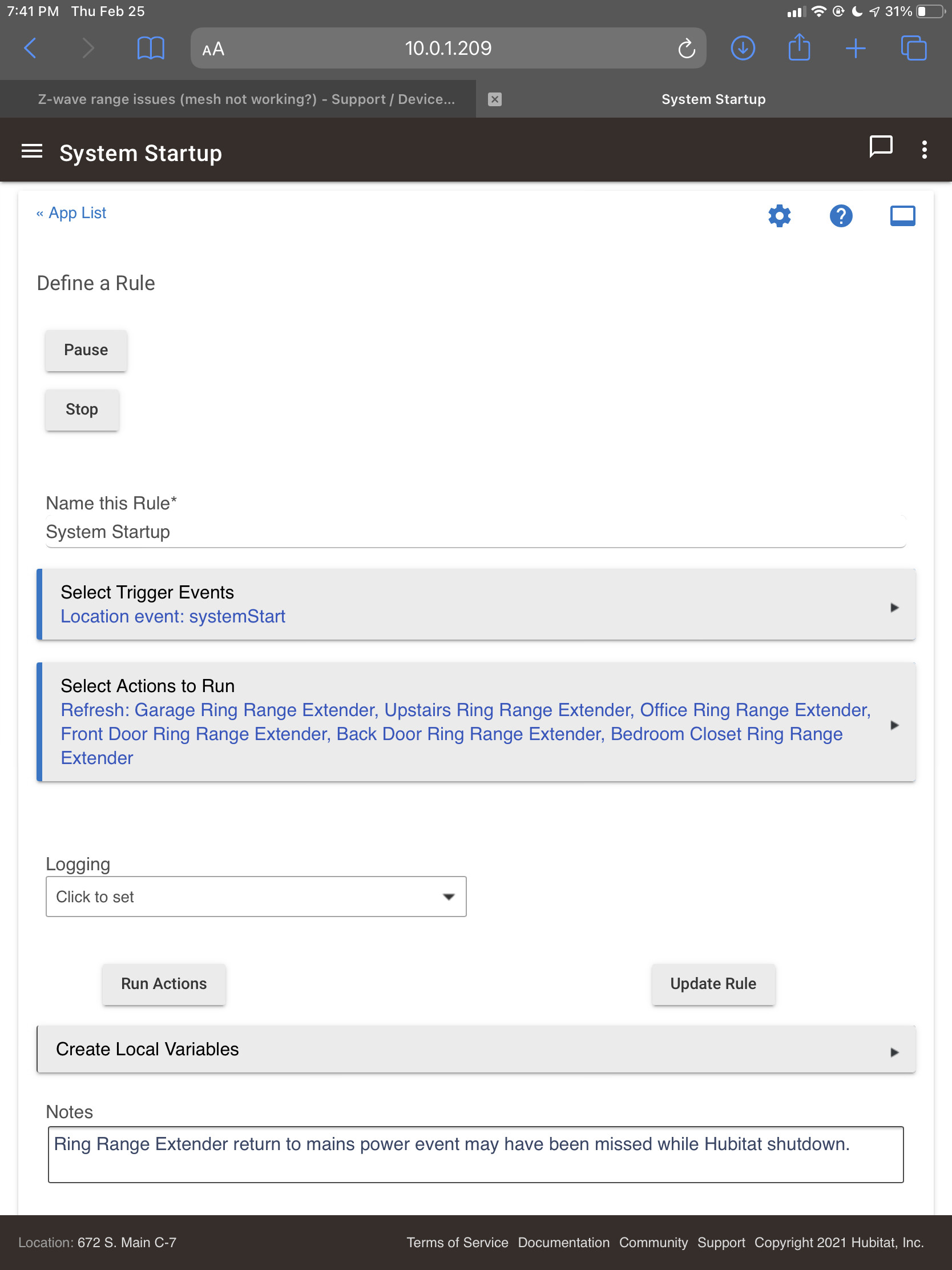

You are welcome. If you decide to use the Ring extenders, note that, during the power restore after the power fail, the Ring extender will come up before your hub, so the hub will miss the “return to mains power” event, so you need a rule on System Start to refresh the state of the Ring extenders. Here is mine:
Refresh Ring Extenders on systemStart

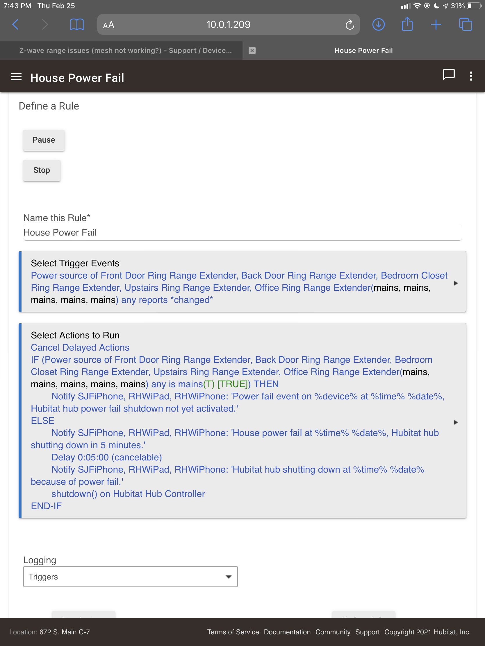

and this rule to shut the hub down on power fail:
Hub Shutdown on Power Fail
