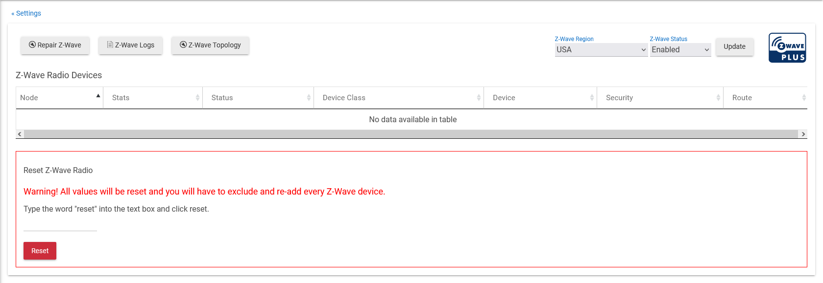

1st Post a copy of your z-wave details page please.

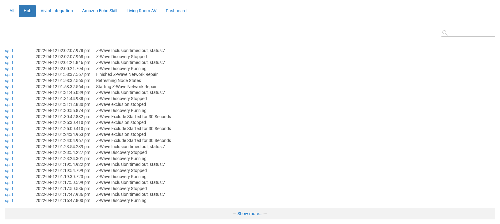

As stated, I already did that on all devices. According to the manuals they did so successfully. See Attached below:
Screenshot 2022-04-12 at 14-15-34 Hubitat Diagnostic Tool
