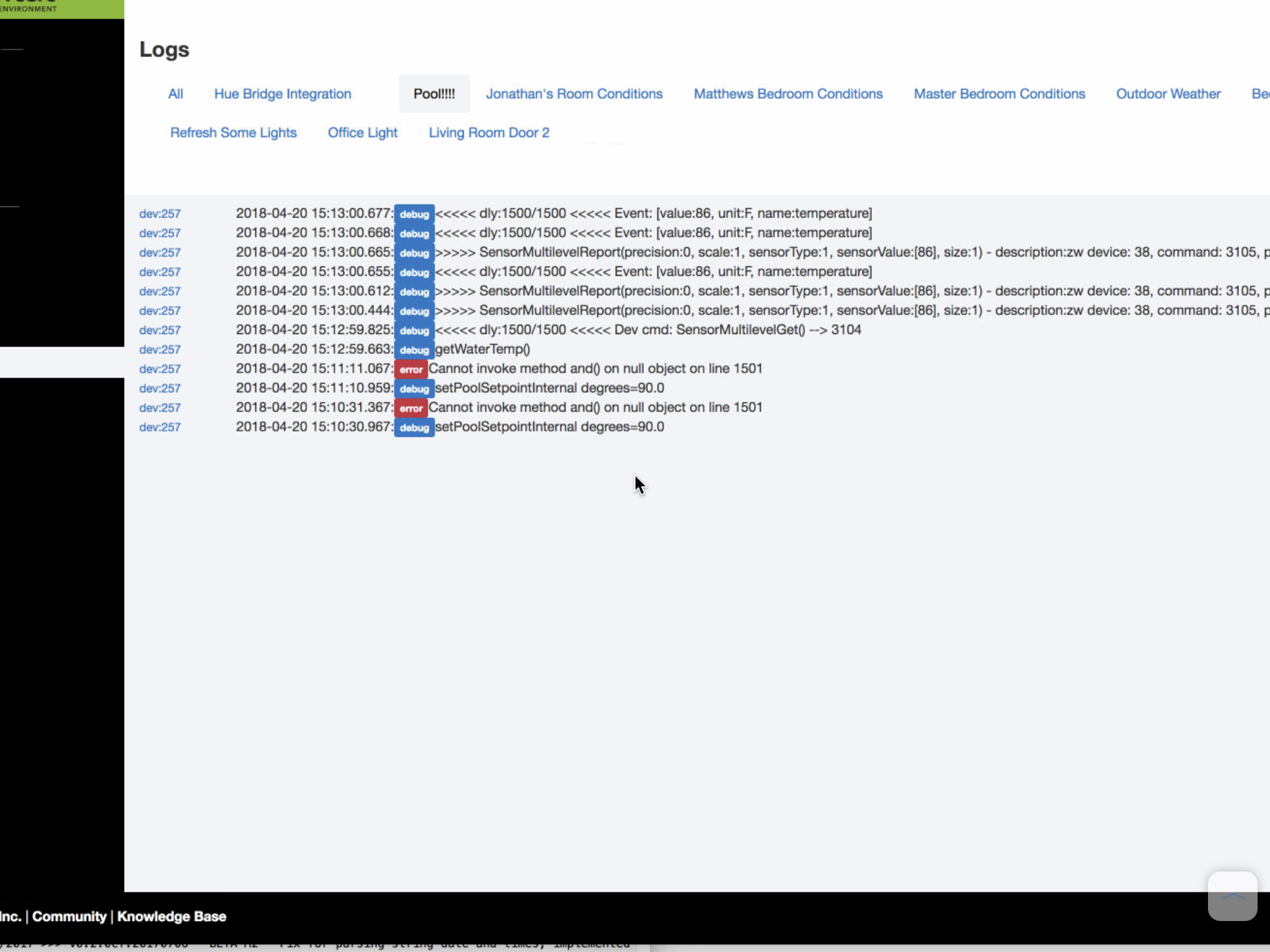

After the firmware update I ran a RM Command to quicksetpool(90) and this is the log. The thermostat on the heater did not change.
I don’t know whether this is firmware related or code related. Any help would be appreciated.
looks to be code related, setPoolSetpointinternal is a method in the driver, it wants a number and appears to be getting a string

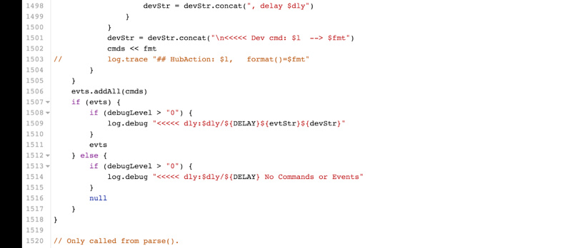

SO i cleared one issue (I think). The driver was casting items as Double whereas HE only understood the cast as Integer.
Now I am stuck at an error at line 1501... here is the message and the code.

This is a very strange error. I will provide some explanation so that hopefully it will allow the support folks a trail to follow.
The “delayBetweenLog” method is just a souped up version of delayBetween. The idea is that various DTH commands often need to send multiple commands and multiple events. As always this is accomplished by returning a List of objects as the return parameter from the command. The PE653 Z-Wave device is very time sensitive so you have to be careful not to overrun it. Consequently you need delay statements between the commands. My version still provides this basic functionality but also provides a common logging framework so that uniform log messages are always provided. To achieve this, the delayBetweenLog method must parse the List and take different log specific action depending on the type of each item in the List.
In the particular case that Justin is executing a command method to set the heater thermostat and follow this with a query to get the current setting (quickSetPool --> setPoolSetpointInternal). Within the Internal method a fresh List is constructed and two ZWave commands are appended to the List:
cmds << zwave.thermostatSetpointV1.thermostatSetpointSet(setpointType: 1, scale: deviceScale, precision: p, scaledValue: convertedDegrees)
cmds << zwave.thermostatSetpointV1.thermostatSetpointGet(setpointType: 1)
The List is then returned to the caller:
def List quickSetPool(degrees) {delayBetweenLog(setPoolSetpointInternal(degrees), 3000)}
but when delayBetweenLog is called with this list, as it iterates through the List, the first item off the List cannot even be printed. The log-trace at line 1470 is simply trying to do a print on the item, yet this is causing the strange error: “Cannot invoke method and() on a null object on line 1470”.
This implies that one (the first) of the commands did not generate the required ZWave command but returned null instead.
I would take a very close look at: zwave.thermostatSetpointV1.thermostatSetpointSet()
Justin, I could add code to protect against a null item in the List so that no error is generated, but that won’t help in the least because you still are not going to get the thermostat set since the creation of this command seems to be the issue.

currently this command requires the size parameter, which is missing from the above.
size is the number of bytes required to render scaledValue, I'll see what I can do about calculating that if it's not included.
