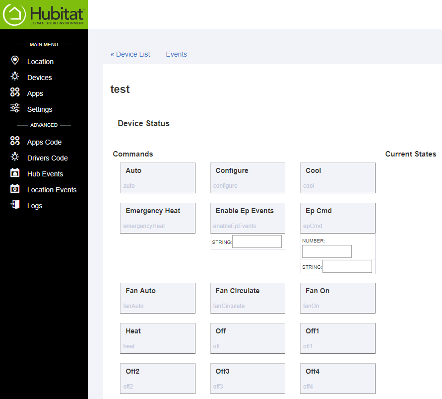

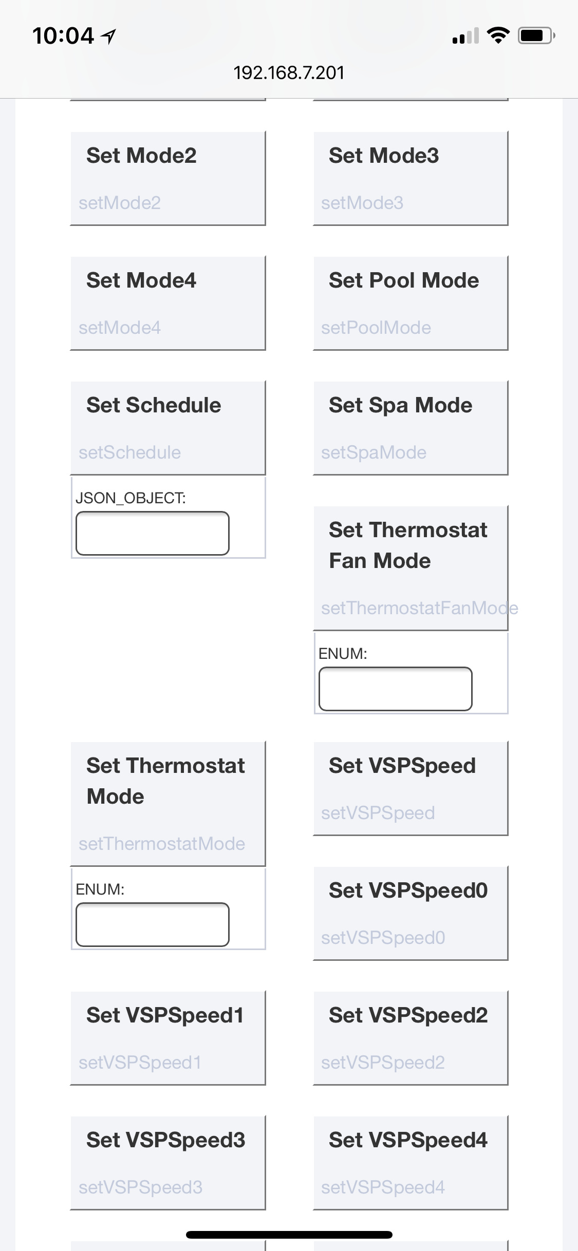

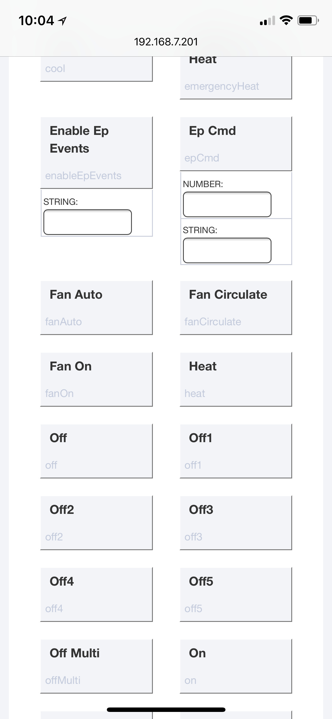

Aha! I was looking in the wrong spot. One of my drivers (for some reason) has the preferences showing at the top above the commands, and two others have them at the bottom. O_o

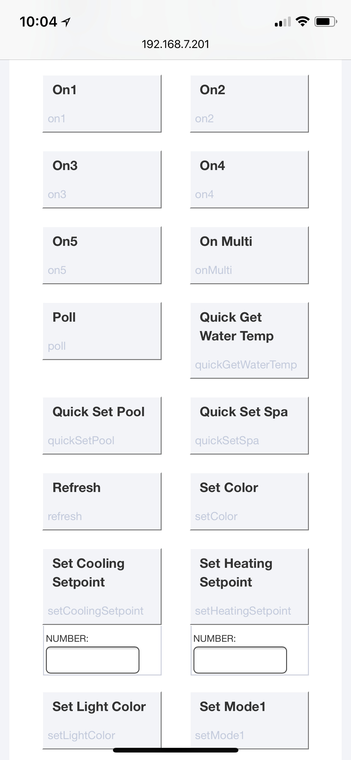

I now have full control over the variable speed pump!!! All four modes. However, now I canât change the temperature.
If enter a number into either âSet Cooling Setpointâ or âSet Heating Setpointâ I get this log
[dev:257](http://192.168.7.201/logs#dev257)2018-03-17 19:25:39.605:errorNo signature of method: dev15213286449791333222929.setHeatingSetpoint() is applicable for argument types: (java.math.BigDecimal) values: [90] on line null
Any ideas? I get temperature control working Iâm home free and I can upload a github with directions and tell all the ST users to try hubitat.
I would have to assume the driver does not understand the setHeatingSetpoint() command. Gleaning from a thermostat driver, is there a different way to change the temperature?
I have a working thermostat driver here: Sinope smart thermostat maybe you could adapt some of that code?
heatingSetPoint is the command defined in the sinope driver. I think itâs just an undefined command needing some attention.
