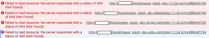

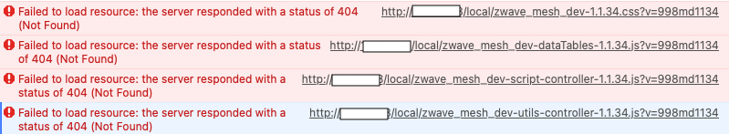

so I enabled the developer tools - and then opened the javascript console - not sure if that's what you wanted - if not, please let me know and I'll re-run it.
Here are the results of the javascript console:
[Error] Failed to load resource: the server responded with a status of 404 (Not Found) (zwave_mesh_dev-1.1.34.css, line 0)
[Error] Failed to load resource: the server responded with a status of 404 (Not Found) (zwave_mesh_dev-dataTables-1.1.34.js, line 0)
[Error] Failed to load resource: the server responded with a status of 404 (Not Found) (zwave_mesh_dev-script-controller-1.1.34.js, line 0)
[Error] Failed to load resource: the server responded with a status of 404 (Not Found) (zwave_mesh_dev-utils-controller-1.1.34.js, line 0)
that was a copy from the logs - I'm also pasting a screenshot as it shows some other info - I blocked the local IP of my hubitat in the screenshot.
