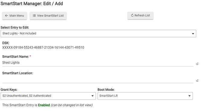

I am running a C8 hub with the latest firmware - 2.3.9.154. I'm having trouble adding a LR device. I tried the documented procedure twice.
I used the SmartStart feature in the app, and the device shows up as "Included" with a node ID and the correct long code number. After the device showed up on the SmartStart list in the app, I edited the device to give it a name and saved it. I then plugged the device in and turned it on. The device is about 4' from the hub.
I also downloaded the SmartStart Nanager app and installed it on the hub. It shows the device on the list, but when you click on it, here is what is displayed:
I find it odd that the browser UI says the device is not included, but the mobile app does.
After an hour or so, crickets, the device never shows up in the device list in either the app or from a web browser.
Prior to attempting the SmartStart addition process, I ensured the device was reset to factory defaults. This is a Minoston Z-Wave Plug Outlet - model MP21Z. I bought it to replace a really old GE outlet plug that is no longer responding its state to the hub.
I'll leave it plugged in all night to see if anything happens, but if I missed a step or there is something else I need to do, let me know.
I may just punt and add it the traditional way, but the LR feature would be nice.
The first thing I'd do is check Logs -- at this point possibly Past Logs -- specifically for events from the "Hub" or "sys:1". If you see any errors about bootstrapping, as some users who've migrated their radios have, it may eventually work if you try enough times (I ran into this once and it did for me), but the only other "fix" might be waiting for some upcoming (no timeline...) Z-Wave changes on the hub or (certain to work but more of a pain the more devices you have--and not where I'd recommend starting) a radio reset.
The third-party app you found for the hub just reads the same endpoint/data the mobile app uses, AFAIK, so it's unusual that they would show different things. I believe this app only fetches it when the "main" screen is loaded, not on every page load of any page, so it's possible you're seeing old/cached data. But your "Devices" list or (if you aren't affected by a problem with disappearing nodes) Z-Wave Details would tell you for sure if the device is there. The table-based view in this app is also easier to see this in, IMO.
Yes what @bertabcd1234 said is correct. The Hub app (that I created) reads the same data point as the mobile app. Try force closing the mobile app and re-opening it to see if it will read the data from the hub again.
Be careful editing the name of the device in the mobile app, if you are not using the Beta 2.0 app then it will change the boot mode to mesh since the old app does not have a LR option.
Looks like it is currently set to LR mode so that should be good.
Possibly the device started including but then failed so it is stuck in a state of not paired but it not going into the discovery mode.
I would shut down the hub and unplug for 30 seconds then re-plug and boot.
Once it is booted back up, open a live logs on a new tab. Then either run an exclusion on the hub and device (you should get unknown device excluded) OR you can also just factory reset the device. This should kick it into pairing mode and within a minute you should see a log message about SmartStart pairing starting, followed shortly after that (10-30 seconds) by debug logs while the device is configured.
