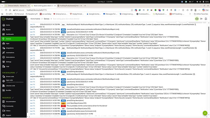

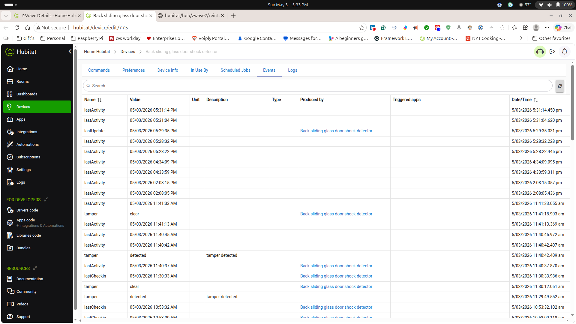

Events, I get nothing
Debug Logs
Zwave
I do see stuff happening, but the device appears not to be functioning.

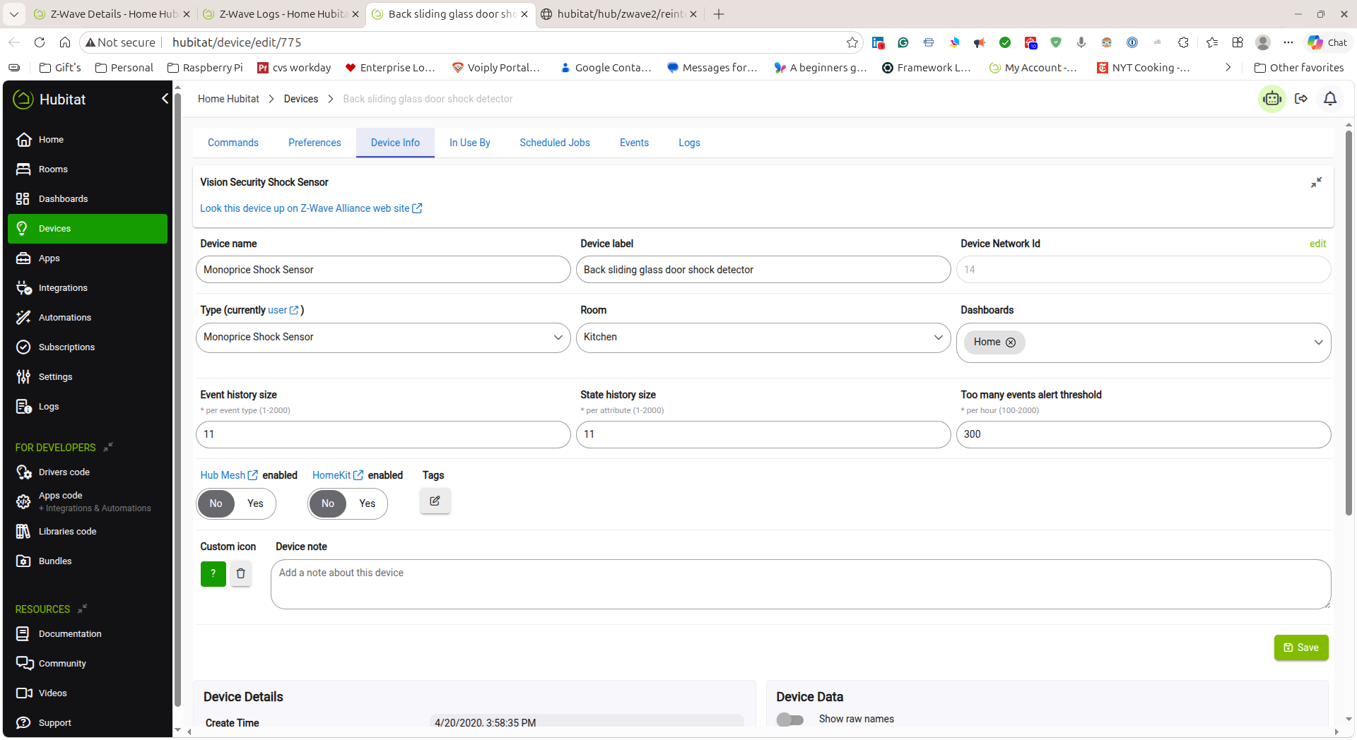

I'm using DHL, a third-party service everyone uses for this type of device.
DHL
I have been trying different drivers, but nothing has worked. :frowning:
Any recommendations?
Sounds like Jeff will drop back in to check the response from the endpoint he gave you...
When I ran the URL Wake interview, it just said done, and I provided the Debug logs. I'm sorry may I don't understand.
Need a link to that user driver you are using.
It appears the device is sending an Intrusion alarm to the hub, and the driver is not doing anything with it. I wonder if the driver is expecting a sensor binary report and ZWJS is suppressing it or something in favor of the Notification report?

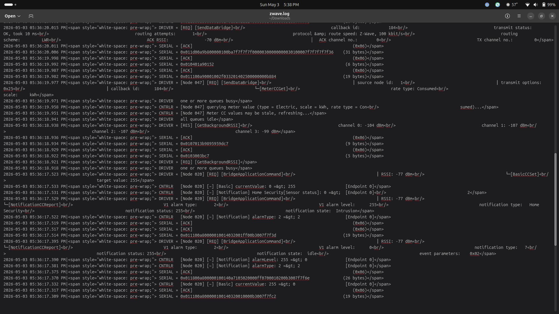

The Zwave logs would be much more useful in text format (can paste in a code block or upload to pastebin.com)
Just to confirm I ran your log screenshots through AI and this is one of the items it came back with for me. I mean I could sit there and decode it all manually but AI works great for this stuff.
2. "Intrusion" Event Confirmation
The log confirms that the device is successfully sending specific security alerts:
  • Notification Type 7: This is "Home Security."
  • Event 2: This corresponds to "Intrusion / Motion Detection."
  • Sequence: You can see the transition from Sensor status: 0 -> 2 (Idle to Intrusion) and back again. This confirms the hardware is working and the Z-Wave mesh is delivering the specific alarm packets.

Motion did not show up at all. Just a blank entry as per the screenshot above. I did flip it back to legacy because I was running out of memory. I was around one Meg of memory so I did flip it back temporarily. But I'll be happy to do more testing. The tamper did register when I opened up the cover but none of the motion sensing shows up at all.
