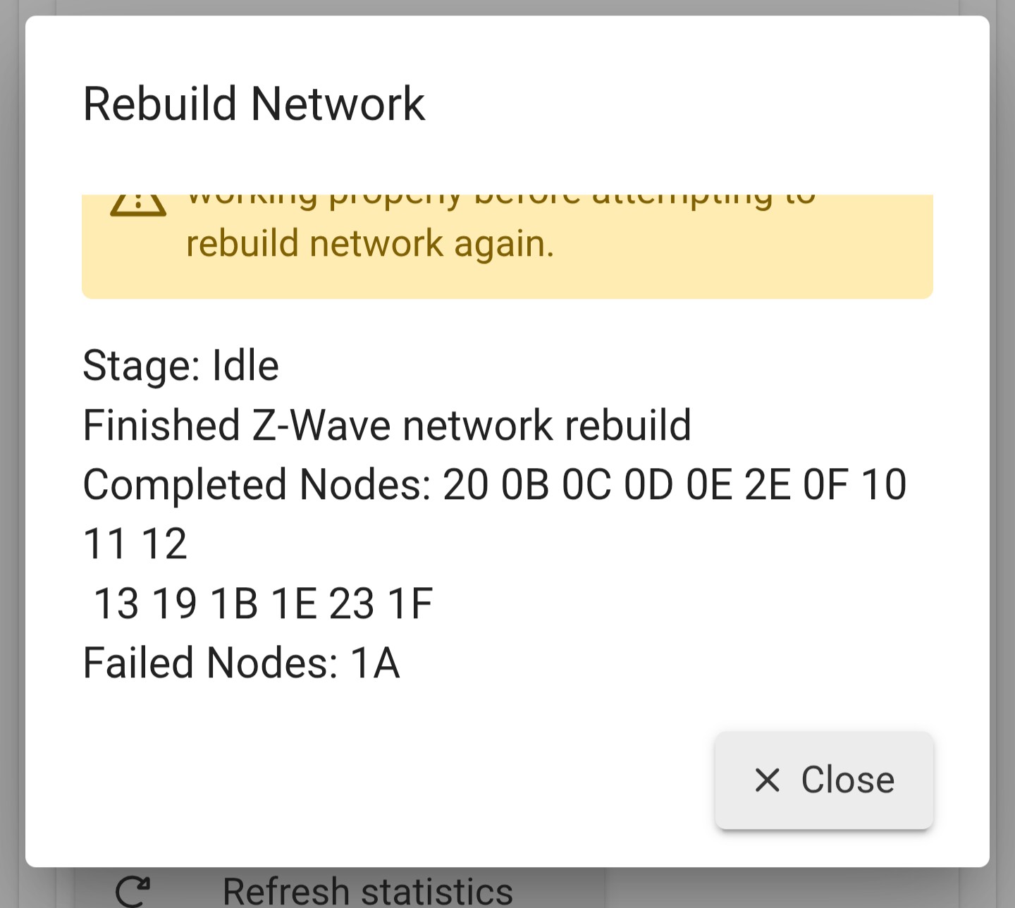

I ran the rebuild and the lock (21) didn't show up in either the successful or failed nodes. I have one failed one that is a siren that I will need to check on but the thermostat (1e) is not working correctly either. I can't send commands to it and it isn't reading correctly from what the thermostat is doing.
Looks like your siren is being problematic
Yes, I will check that one. It chews through batteries (or at least the system says it does) and at this point I am not even sure if it is on.
