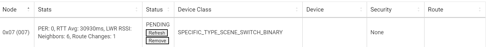

I have (had) a number of ghost z-wave devices on my C7, and was told that they can have an effect on migration to the C8.
The other day I started with 10, and now have reduced it to 3 (which are being very stubborn).
Any advice on easily getting them removed?
At this point, I have no idea what the original devices were.
Refresh and Remove seems to do nothing.

WHen you say still powered up, you mean it is still a device on the system?
Are there any ways to identify it?
You can try by class.

I would gladly power on the devices again if I could determine what they were
