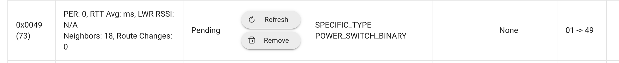

Since Sept 25, I've been facing a lot of problems due to network issues and firmware. Somewhere in the intense troubleshooting, I eventually thought that one of my z-wave devices has gone bad (I was incorrect, it turns out to be the zwave and network incident that was recently fixed). At the time, I tried to exclude the zooz switch which then created a ghost. I am able to include the switch as a new zwave device, but the previous device refused to be removed despite:

Forgot to include the screenshot of the ghost.

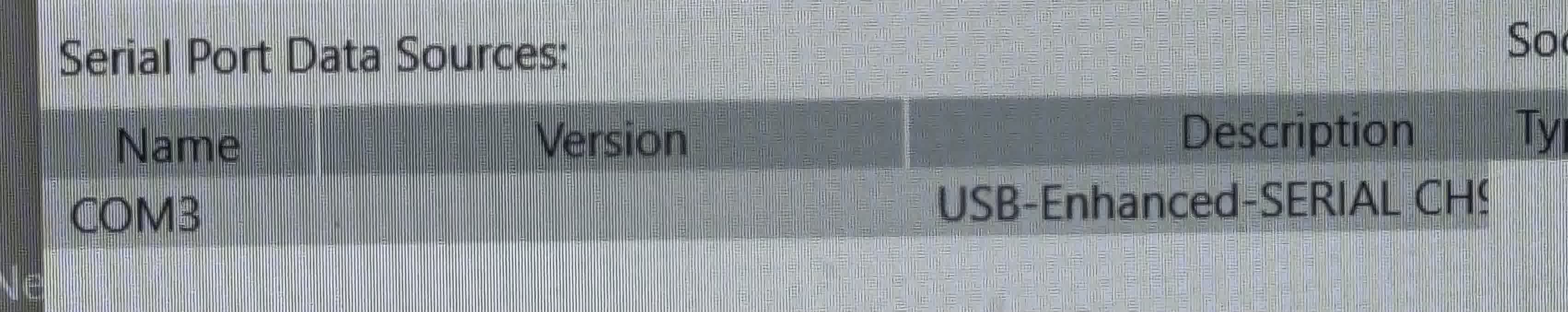

  3. the Zooz stick 800 does not show version number as in the screenshot when trying to discover the stick in the controller software. Please add a note for others. I thought my stick was broken or more likely I was doing something wrong until I took a leap of faith and continued.

Regarding what the Zooz stick showed/didn't show in the screen below - I are you saying it lacked any info in the "Version" column, or only showed something like "ControllerBridgeLib" and didn't include a number, or ? If you have a screen show that will be quick and easy to share. Just want to clarify what showed in the Version and Description columns.

I've updated the doc in a few areas, including info on some UZB sticks (like Zooz) not showing version info, the potential for many, many tries required to join UZB sticks to the hub, confirmation you can join your UZB stick with or without security, etc.

For the Zooz ZST39 LR:
Also of note: when the stick is inserted, a Port is created in Device Manager. However, an Unknown device is ALSO created. I don't know if that is helpful or hurtful in this whole process.
