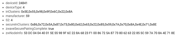

I recently replaced my very old Schlage FE599 Z-Wave Lever Lock (running on a C-4 hub) with a Schlage JFE109 Connected Lever Lock. I used the SmartStart procedure to join the lock to my C-8 hub (running 2.3.9.200) with S2 Security. It joined immediately when I installed the batteries in the lock but it was (auto) identified for driver "Device". I changed it to the "Generic Z-Wave Lock" driver. It seems to be working well.
Below is the fingerprint logged when the lock connected:
fingerprint mfr:"003B", prod:"0004", deviceId:"6109", inClusters:"0x5E,0x55,0x98,0x9F,0x6C,0x22,0x8A", controllerType: "ZWV"

Device Details - Data:

Thanks! This fingerprint will be added to the Generic Z-Wave Lock driver in 2.4.0.
