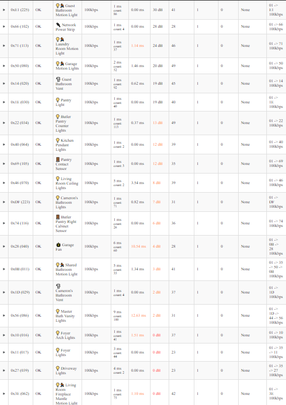

Yeah - that is why I am hoping it finds better routes over a few days. many of those devices are in the "middle of the neighborhood" and should not look that lonely. Only that shed door contact sensor is really alone, since it is now out at the shed, and even that has a few neighbors it could reach much easier than the Inovelli switch it is routed through. The Inovelli switch itself is only about 25 feet from the hub on the same level, so it doesn't seem like it should have so many hops.
On that list - 18 are mains powered and by specs should be repeaters, and only 5 are battery powered. I will be adding a bunch more switches in time, and then more battery powered devices, too.

When I started getting Z-Wave devices back, the first four were a pair of outlets and a pair of door sensors. These came in way before the rest of the items eventually started working, and it didn't make sense why they were the only ones that worked at the time.
It was also pointed out in this thread that as more devices came in, that these original 4 didn't really find any neighbors. As of yesterday these devices still just had 1 or 2 neighbors, even though they are physically near all the others that now have 25 or so neighbors each, and these 4 have had plenty of time map themselves.
So - As a test I excluded and re-included one of these original door sensors that had just 1 neighbor as of yesterday. Within a half hour this device had 26 neighbors.
While I really can't explain why many things have worked the way they have with my C7 so far, this one seemed odd to me. I intend to exclude and re-include the other 3 to get them out of that walled off neighborhood they seem to be in.
