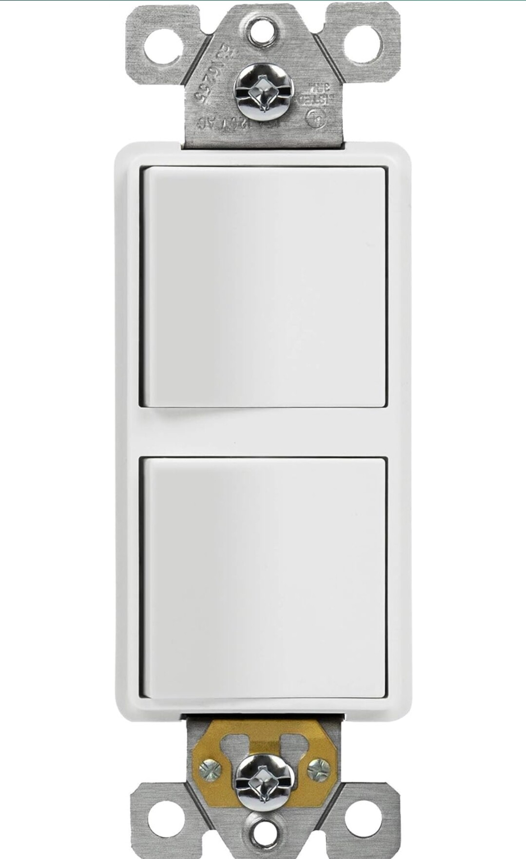

Hi all. Are there Z-Wave single space wall switches with two channels both having wired switching? No dimming. Basically I need to replace these kind of simple double channel switches (see picture) to switch 2 independent channels.

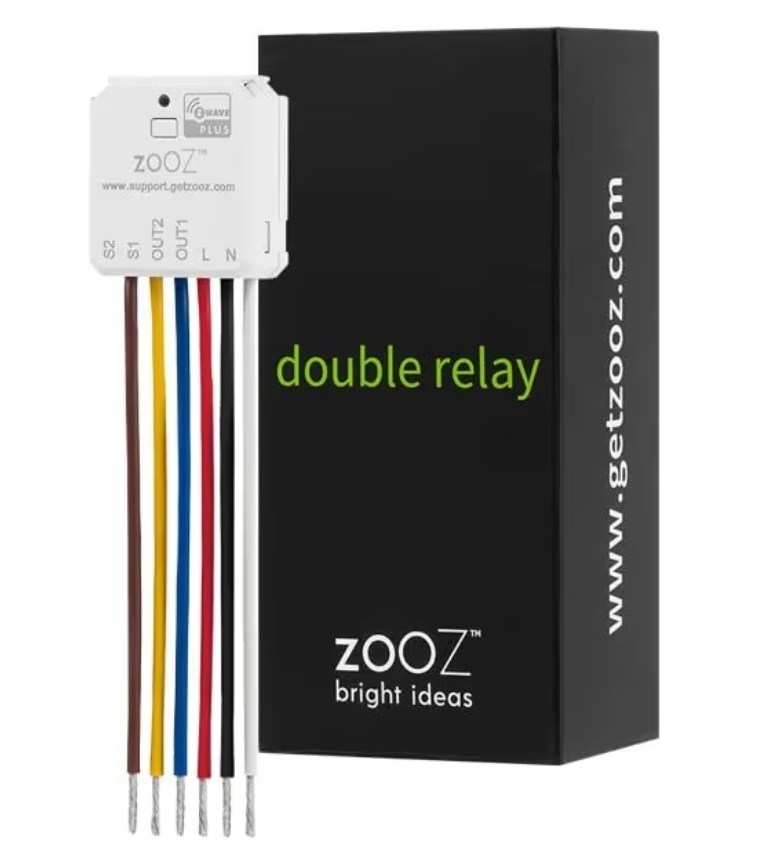

I'm trying to avoid relays such as the one pictured below because, as I understand it, they will require removal of regular switches over them to access the reset button in case of lost connection to hub or freezing... (resetting a breaker is not desired either)

You could also keep what you have on the wall and just use a dual relay behind the scenes, like the Zooz ZEN52 or the Aeotec Dual Nano, or anything else along these lines.

Aren't those require removal of the regular switches to access the reset button in case of lost connection or freezing? I'm really trying to avoid this!!

I mean, if you need to access Z-Wave network functionality, like to exclude, yes, but that shouldn't be very common. They provide switch connections (where you could hook up your existing switches) that would work with or without Z-Wave.

An alternative: similar to the above, you could use a relay at each location (might need to do if neither of the dual options is rated for 15 A?) rather than at the switch itself. Most of these again have terminals for switch connections, which would give you similar control.
