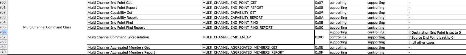

15:47:47.373:debug Parse input: zw device: 1F, command: 600D, payload: 03 03 26 03 10
I believe that's Multi Channel Command Class + Encapsulation
MULTI_CHANNEL_CMD_ENCAP 0x0D supporting controlling If Destination End Point is set to 0
controlling supporting If Source End Point is set to 0
supporting supporting In all other cases
I thought it was command: xxyy
xx = command class
yy = command within that class.
