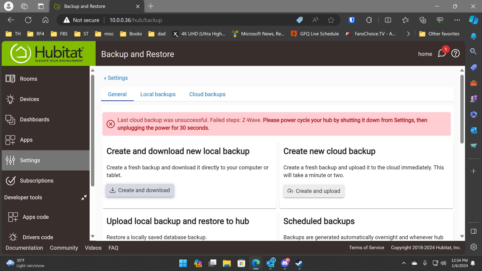

Hi all c7 i have shut it down unplugged for 30 sec still see the error
Did you try a manual cloud backup after?
I have a similar problem. Both the scheduled backup and the manual backup give me this error.
Any idea anyone - want to make sure my backup is working before I upgrade.

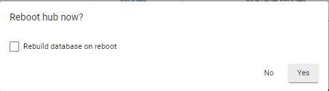

I forced a reboot of the platform before - just to make sure...
But I didnt check the Rebuild database checkbox...
J.
You'll want to do a shutdown of the hub and remove power for about 30-45 seconds, and then retry the backup. As a reference point what hub model and firmware are you on?

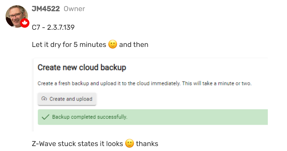

C7 - 2.3.7.139
Let it dry for 5 minutes :slight_smile: and then
Z-Wave stuck states it looks :slight_smile: thanks

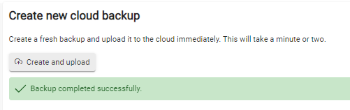

Update, and then start a cloud backup manually on .146.

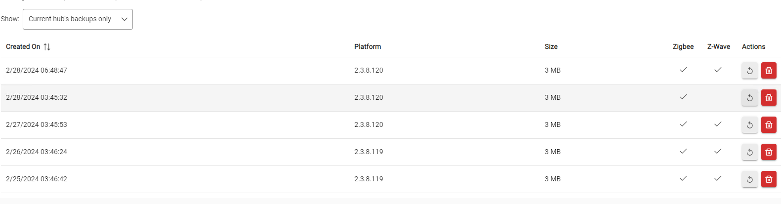

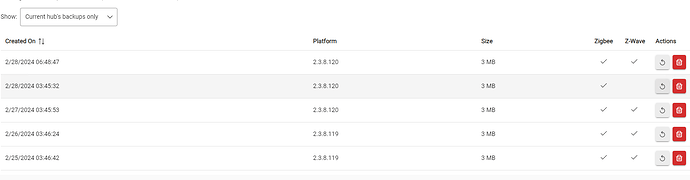

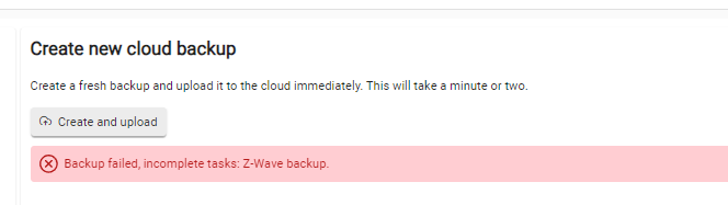

Same z-wave backup error - C8 with 2.3.8.120. Error appeared after recent update to 2.3.8.119:
Z-wave partially stop working after this error. Only the power cycle restored full z-wave functionality.
