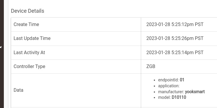

Please post the information from the device web page ‘Data’ section when paired to HE

Hi is this what you mean?
Yes, this information uniquely identifies the device.
It uses the standard Zigbee Window Covering cluster, so should work with the inbuilt Generic Zigbee shade driver... Should work also with this custom driver as example :
