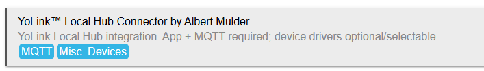

YoLink™ Local Hub ↔ Hubitat (Local-only) — App & Drivers (BETA)
I’ve been building an App and a set of device drivers that let Hubitat talk directly to the YoLink Local Hub, with no cloud dependency. Events come in over MQTT from your local hub; periodic “reconcile” calls use YoLink’s local HTTP API. It’s fast, private, and keeps working even if the internet is down.

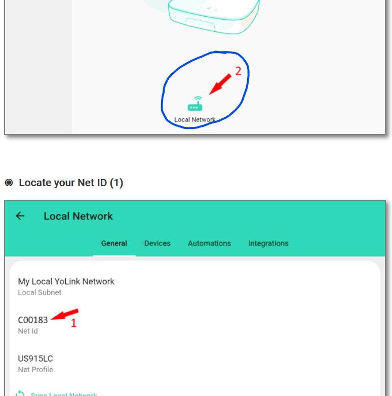

  • You enter the Local Hub’s IP, Subnet (Net ID), Client ID, and Client Secret.

Anyone know why my app does not have the local network icon to select?
Are you sure you have the "Local Hub" not the normal hub? If you do have the Local Hub, then you will want to reach out to Yolink and find out what the issue is, as that is part of the local hub, with out that showing you can not add you devices to the local hub and use this app/drivers
I have YS1603-UC. Not the one I need?
No, the local hub part number is YS1606..
