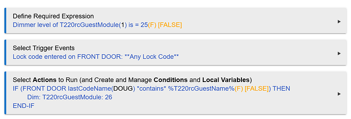

Thank you all for your input! I came up with a simple solution in Rule Machine that works just fine. See below.
For context, for each of my Airbnb units I've created a virtual dimmer which I use to control all sorts of different functions/events for a guest stay; I call it the guest module. When the guest module for a particular unit is set to 25, that triggers all of the procedures to get a unit ready for check in, such as setting the lights to a particular level, activating door codes, and displaying the guest's name on a tablet mounted in the wall in the entry, as one example. The guest's name is stored as a variable on the hub, with a separate variable for each unit. Here's the rule I put together to automate the process when the guest actually arrives and checks in, which switches the virtual dimmer (guest module) to level 26. That triggers all sorrts of other events, such as sending the guest a welcome text message, alerting me that the guest has checked in, turning on power in the unit for the mini fridge, etc.
