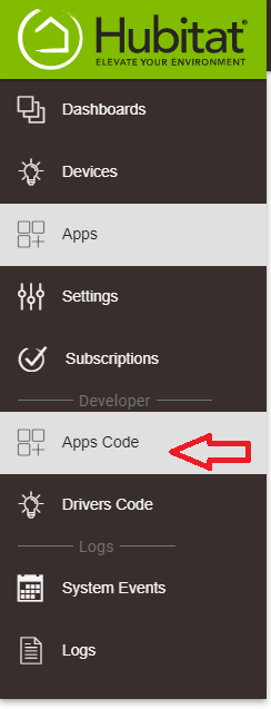

Also make sure you are adding a new App, not Driver.
sorry for that, I tried add to new drive! :laughing: Its correct now!
