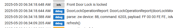

There is a refresh button on the device page. Might not show up in RM unless you use custom actions.
I have a Yale Assure SL2 YRD256.
It does not appear to get a battery report with the refresh though.

The hub just displays whatever the device reports, there is no magic to it. You can check the event log to see when it is getting reported. Typically battery events are forced so it should show in the everts even if it has not changed. Locks typically report the battery level multiple times a day.
The only way the reporting could be changed is with a firmware update from the lock manufacturer. Or possibly parameter settings.
