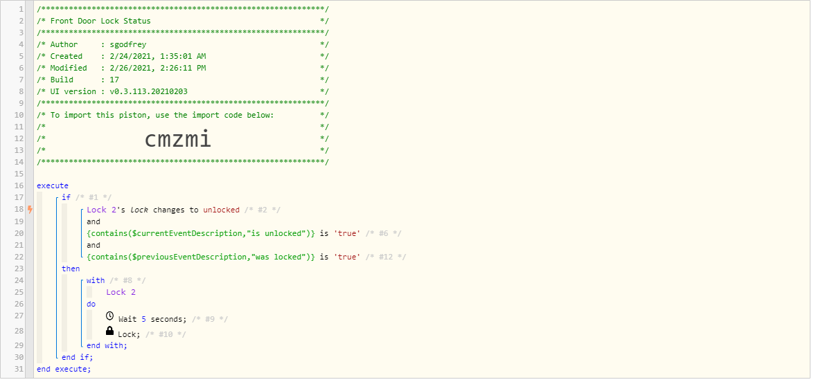

Doing a refresh does nothing and of course, there are battery status updates in the log going forward, so the entry is often buried in the logs. I thought of using 'Reliable-Locks' app GitHub - joelwetzel/Hubitat-Reliable-Locks: An app that will create virtual locks that 'wrap' your physical lock devices, making them more reliable. But since what its does is a wrap a virtual lock of the physical lock and refresh its status, that doesn't seem to work.
Anyway, what I ended up with was some digging into Webcore and how to access the log entries and make logic decision based on currentEvent compared to previousEvent. It seems to be working pretty well, so I wanted to share in case someone else has a similar problem.

The code was in my post
