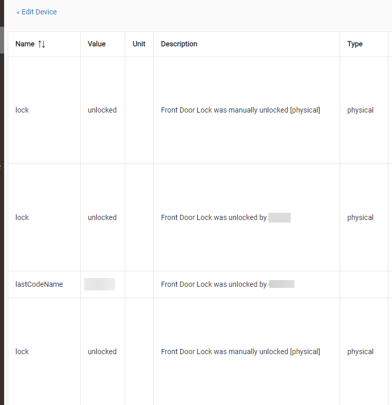

Also would you happen to know if both the Schlage and Yale locks support the same device drivers that my Kwik set does? The reason I ask, are some important automations I use differentiate between a pin code unlock, and simply turning the deadbolt to disarm our setup.
The schlage definitely can do this. Also pretty much any current version is going to be 700 (all mine are)
Here are events from my Yale with the ZW2 module. This uses the Generic Lock driver.
Both show up as a physical unlock but you get the code name event if a code is used.
The "manual" unlocks are probably when it is unlocked from the inside with the thumb turn.
