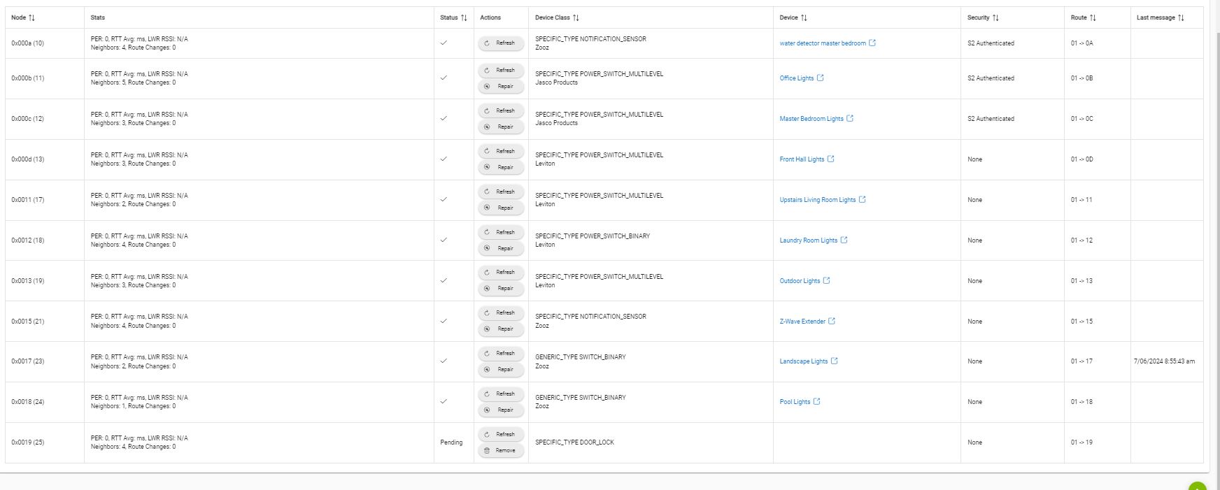

I'm thinking it may because I have under Z-Wave details, a ghost:
|0x0019 (25)|PER: 0, RTT Avg: ms, LWR RSSI: N/A
Neighbors: 4, Route Changes: 0|Pending|RefreshRemove|SPECIFIC_TYPE DOOR_LOCK||None|01 -> 19||
I've tried removing it - and it just says Pending. Any advice would be appreciated.
Click refresh on that line that says pending, a remove button will show up. Can you post your entire z-wave details page (use windows snip)

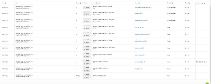

I've tried the various other tips I've seen on this board - rebooting the hub; removing the battery from the lock. No luck so far. At one point there were two ghosts - both for the lock. One I was able to remove, but this one just won't delete.
Okay I've successfully removed the ghost, but I'm back to the same issue where I attempt to pair, get the message:
