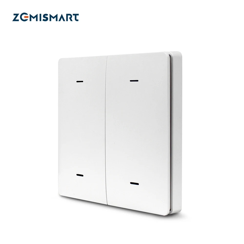

I just tested on 2 switches, one straight from zemismart and one from "Moes".
Both TS004F.
it seems to be working just great so far. Only small quirk I see is that there's seems to be some delay when keys are pressed too quick. could just be a limitation of the switch itself.
But will continue testing see if everything is working over some period of time.
Again, nicely done, many thanks
Edit:
just to add some more info, the odd numeration on the back of the switches on mine (to make it easier for anyone else eventually searching for solution) are:
21/35 and 21/29
