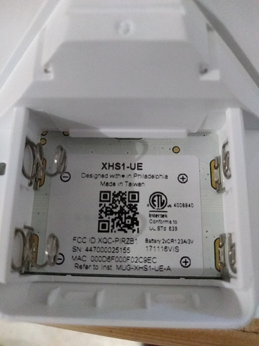

I recently picked up a couple motion sensors from eBay, as part of a lot. They are Xfinity XHS1-UE's. They paired up as Generic Zigbee Moisture Sensors. I changed them to the Generic Zigbee Motion Sensor device, and they work for about 30 minutes, then stop reporting. I get battery, motion, and temperature.
@mike.maxwell
They look like the Visonic motion sensors here:
Did you hit Configure after changing drivers? Sometimes helps.
Yes.
any osrams on the same network?
2 gardenspots and 2 Sylvania dimmer switches.
its unlikely that any of these 4 devices are helping this sensor stay in touch with the hub...
To verify that they are an issue (or not), unplug the four of them temporarily, pull the battery on the motion sensor, then see if that helps...
When all else fails, read the instructions right?
It apparently has a 15 minute walk test, then it rests 2 minutes between activations.
I will keep experimenting.
