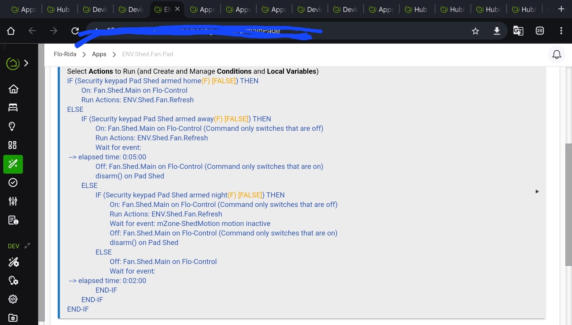

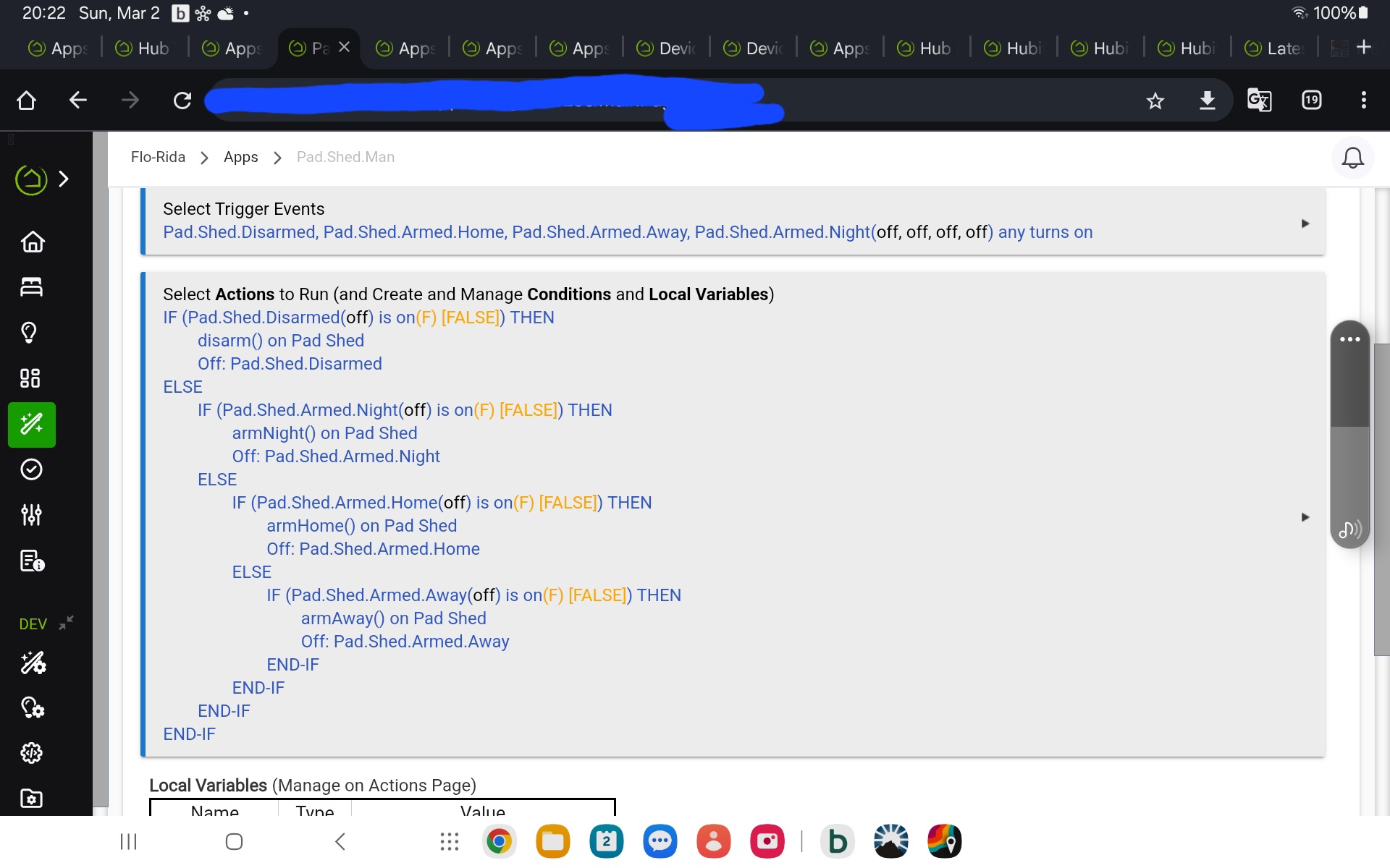

I have several of these keypads, they work great.
The one in the shed is setup to...
Turn on the fan
Or
Turn on the fan using motion sensors, also xfinity
Or turn off the fan in 5 minutes
Or
Turn it off now.
The one on the porch just arms/disarms/sets night mode/sets away.
The one in the hut...
U get the drift.

@woodsy - Cool setup! That's a nice example of some stuff that the keypad can do.
Unfortunately for me, there probably isn't much the keypads would be useful for in our household if the existing security sensors can't be used for anything.
Using your code sample (thanks!), I could probably set up something where I could shut off all the smart light switches and secure all the deadbolts at bedtime, but that's about the only thing that comes to mind.

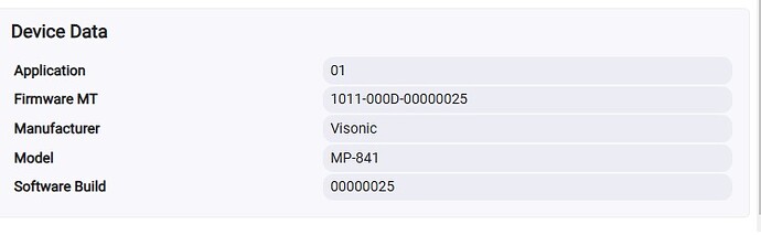

Are they showing motion in your logs? I've got that motion sensor as well. It's using the Generic Zigbee Motion Sensor and works great; though, I do not use Hubitat Dashboard. If it is working in the logs, then there is something else going on and you should probably create a different thread. If the sensor is not showing motion/inactive in your logs, then you might just need to keep at it.
On the preference page, what does your Device Data say? Mine looks like:
OK @JB10, you are correct - I do show the motion sensor going "Active" in the logs. The Hubitat Dashboard may just have some sort of hysteresis before it updates the display.
