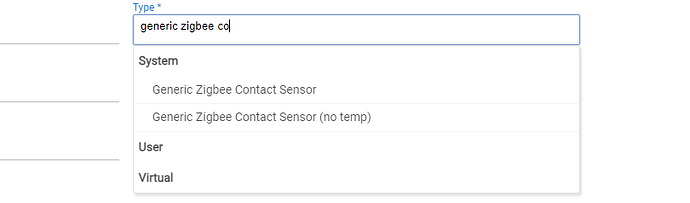

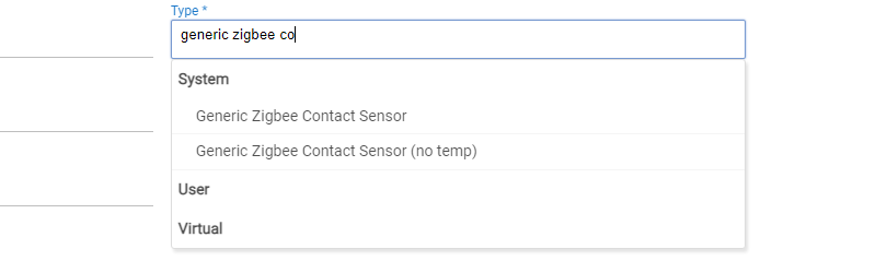

This device should be working using the HE inbuilt 'Generic Zigbee Contact Sensor' drivers.
Change the driver manually (if not assigned already), then pair the contact sensor again (without deleting it), preferably close to your hub.
