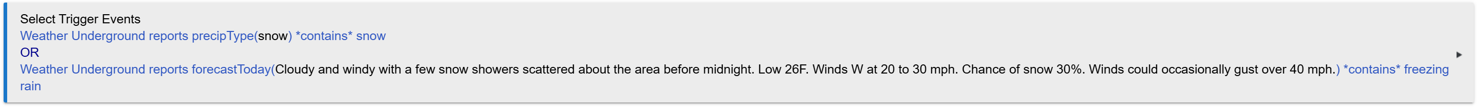

According to the Weather Underground API documentation, for precipType you only get: "rain, snow, precip".
I see that "snow" is reported in precipType. Assuming you would be using Rule Manager to create the rule to turn on your "heat cable relay" you could use a "contains" conditions to check for your conditions. Try using some other fields to find phrases for your conditions. You may have to do some looking at the forecastToday values to find exactly what you want. Here is something I quickly put together as an example, but I do not know if "freezing rain" phrase is used in forecastToday.

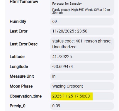

The issue I've had with Wunderground is the data is not updating. I've read others have had this problem. I checked the device and it is set to poll every 10 minutes. I have to manually press the poll button for it to update.
Screenshot 2025-11-26 184037
Here you can see the last time it updated is when I manually did it last night

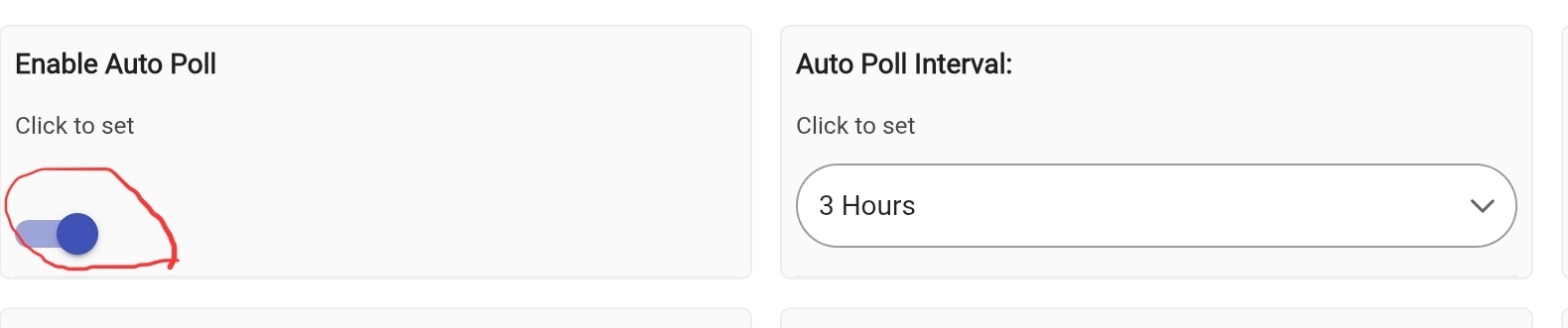

Not sure if this was solved or not. But, I just installed this to replace OWM since they messed up the icons.
Anyhow, I was having the same problem, after a day, it was only updating when I manually refreshed even though I knew I had initially set the interval to 5 minutes. I went back to look, and realized the "Enable Auto Poll" switch is apparently defaulted to off. Even though it is RIGHT NEXT to the interval, I totally just did not see it when I was initially setting it up. Flipped the switch to on, and now it is updating as I want.
