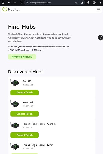

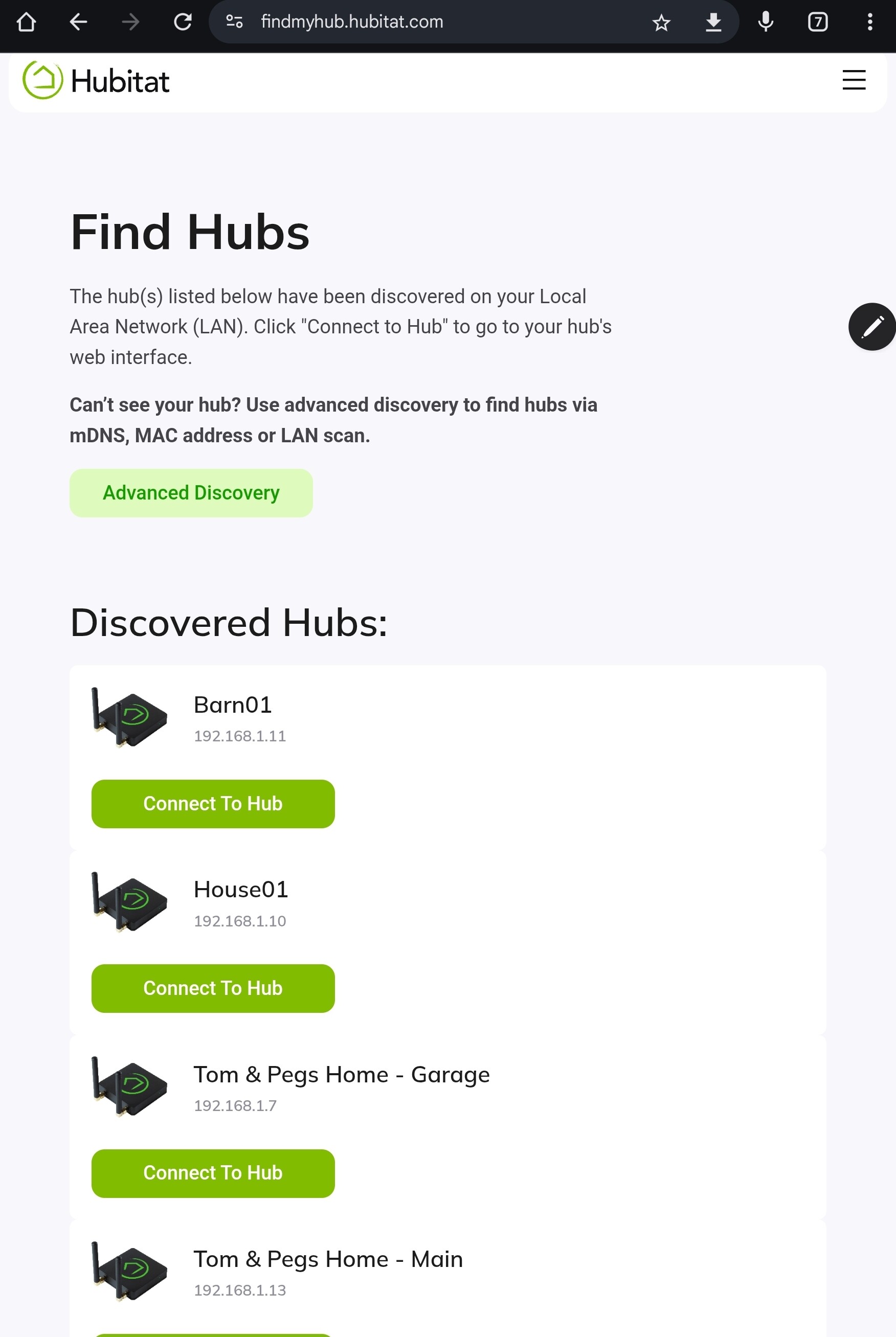

WTF-These ain't my hubs
Not sure who Tom and Peg are, but I'd really like to know why their hubs are showing up on my network scan!
What is your ISP? I am guessing you are on cgnat sharing a public IP with other people. This has come up before. You wonโ€™t be able to connect to them, different LAN. Not totally sure how the scan finds them but I believe it only happens with cgnat.
You would be correct. I'm on Starlink. I just switched from a public IP to CGNAT because of their price increases for public IPs. (Basically I would have gone from $140/mo to $600/mo)
