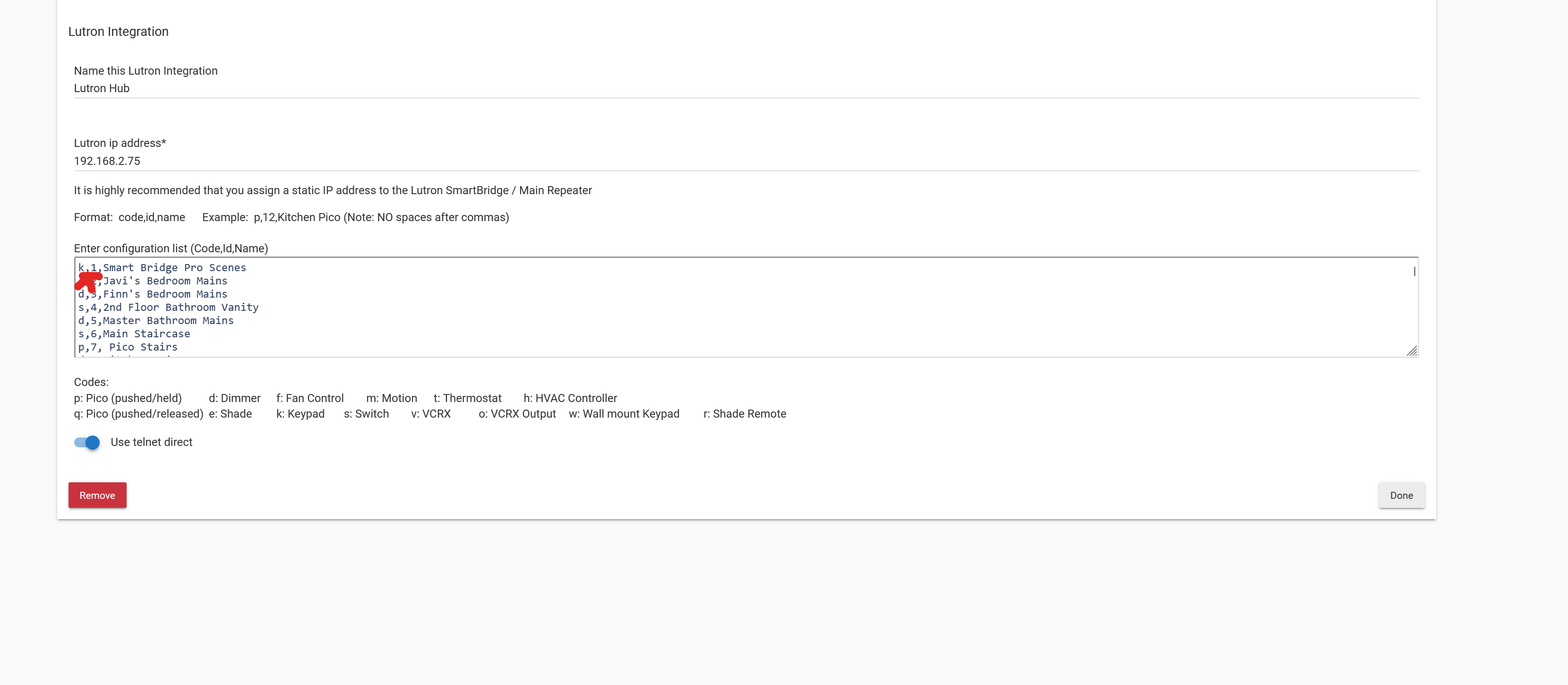

Though honestly if you want to avoid popcorning (one light ticking on/off at a time) create a keypad in the integration. Then set a scene in the lutron app and note the scene button number in the integration report and use that in your rule. So key press 6= Dim bedroom lights for knock boots time. The lights will come on/off as a group. Works well for all off as well.

Sorry for my ignorance -- I'm not sure what this means. Is there a tutorial somewhere for creating keypads?

Just insert k,1,whatevernameyouwantogivetoit in the config code box...
