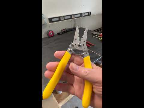

Many of us wind up changing outlets at some point. I've swapped likely close to 100 between my home and helping family & friends.
Anyway here's the magic:
Man I love that. So many things right in front of you just never know that are there.
He left out the fact that there is a little measuring guide on the side of the receipticle that shows you how much to strip.
Yeah but that measurement guide is only for the back stab connections and any electrical worth his salt never use the backstabs.
I’m going to be a little negative here. If I had an electrician using a switch or a plug as a wire stripper, he would be out the door pretty quick.
