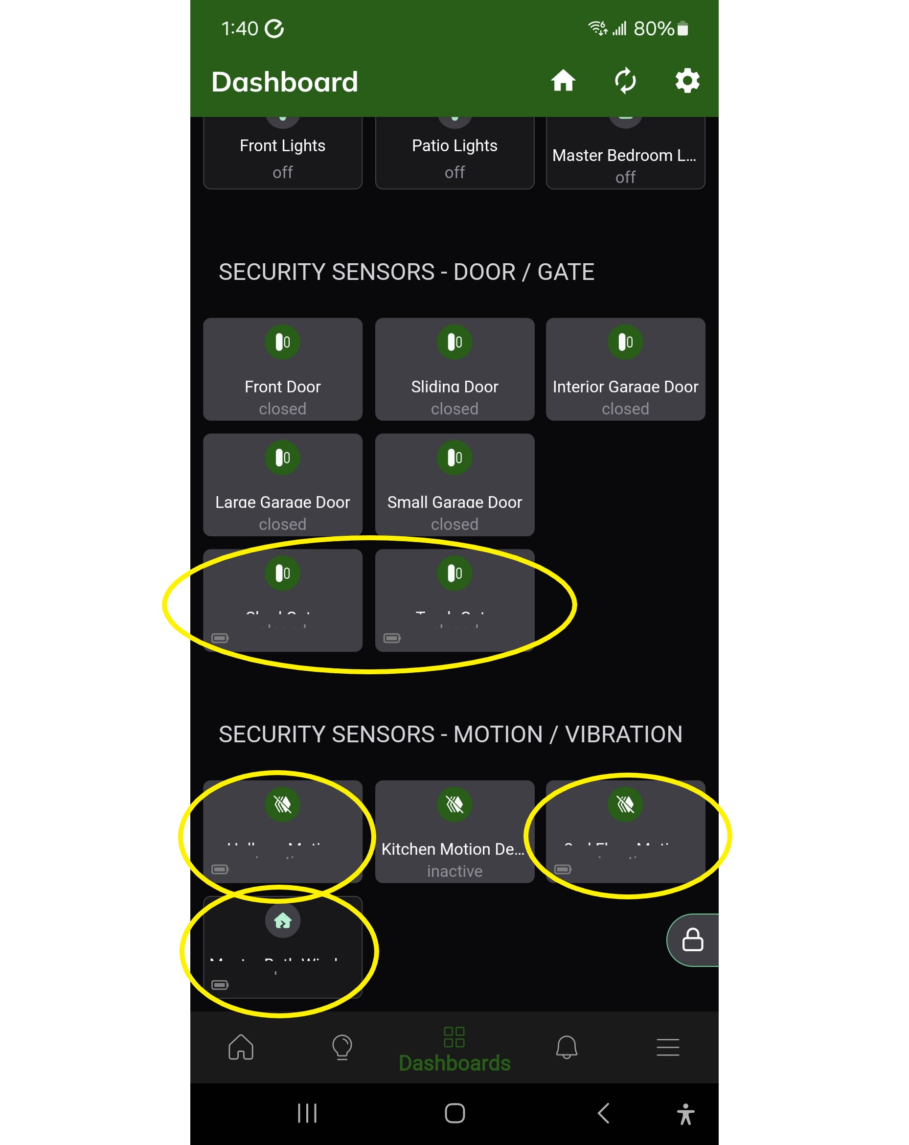

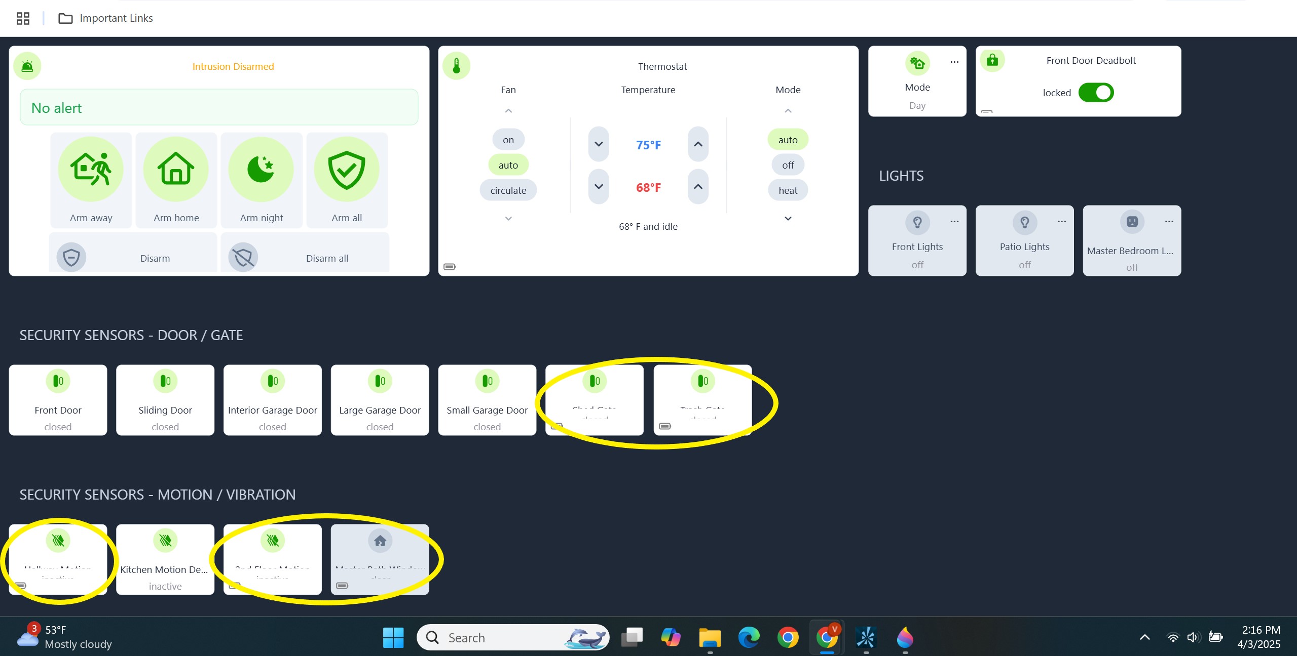

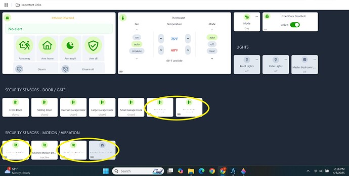

Hi, I'm new in this hubitat/home automation thing, please let me know if this is not the right place to ask. I have a C-8 Pro hub and just upgraded the hubitat version from 2.4.0.151 to 2.4.1.152. After the upgrade, the wording on some of the tiles in my EZ Dashboard became unreadable. See pictures below for reference. This happens for the same exact tiles for both my desktop and app on my Samsung phone. These tiles were fine before the upgrade. I have rebooted my hubitat and phone as well as logoff/login the app in my phone a few times, but the problem remains.

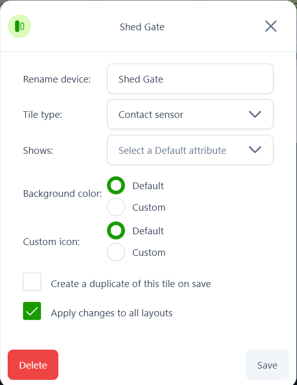

Here is the setting on one of the broken tiles:

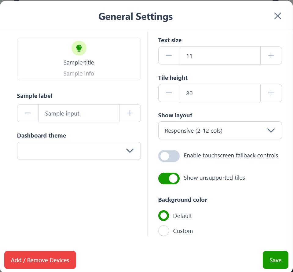

Here is the general settings of the tiles:

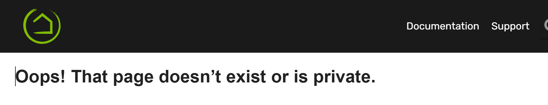

Thanks for the reply. But that link is unreachable for me.
Great referral, but unfortunately, that link is still in the "Beta" Section and not publicly accessible. :frowning:
But I'm sure the staff wouldn't be that concerned if you reply with a summary of the general thread
Temporary fix is to increase the tile height to at least 130

Thanks hydro311 and thebearmay. I increased my tile height to 100, which is good enough for me.
