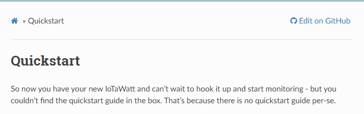

Oh oh, looks like it will be a long weekend based on this info:
I had it hooked up and running and calibrated in about a half hour....Working on adjusting my rules to it

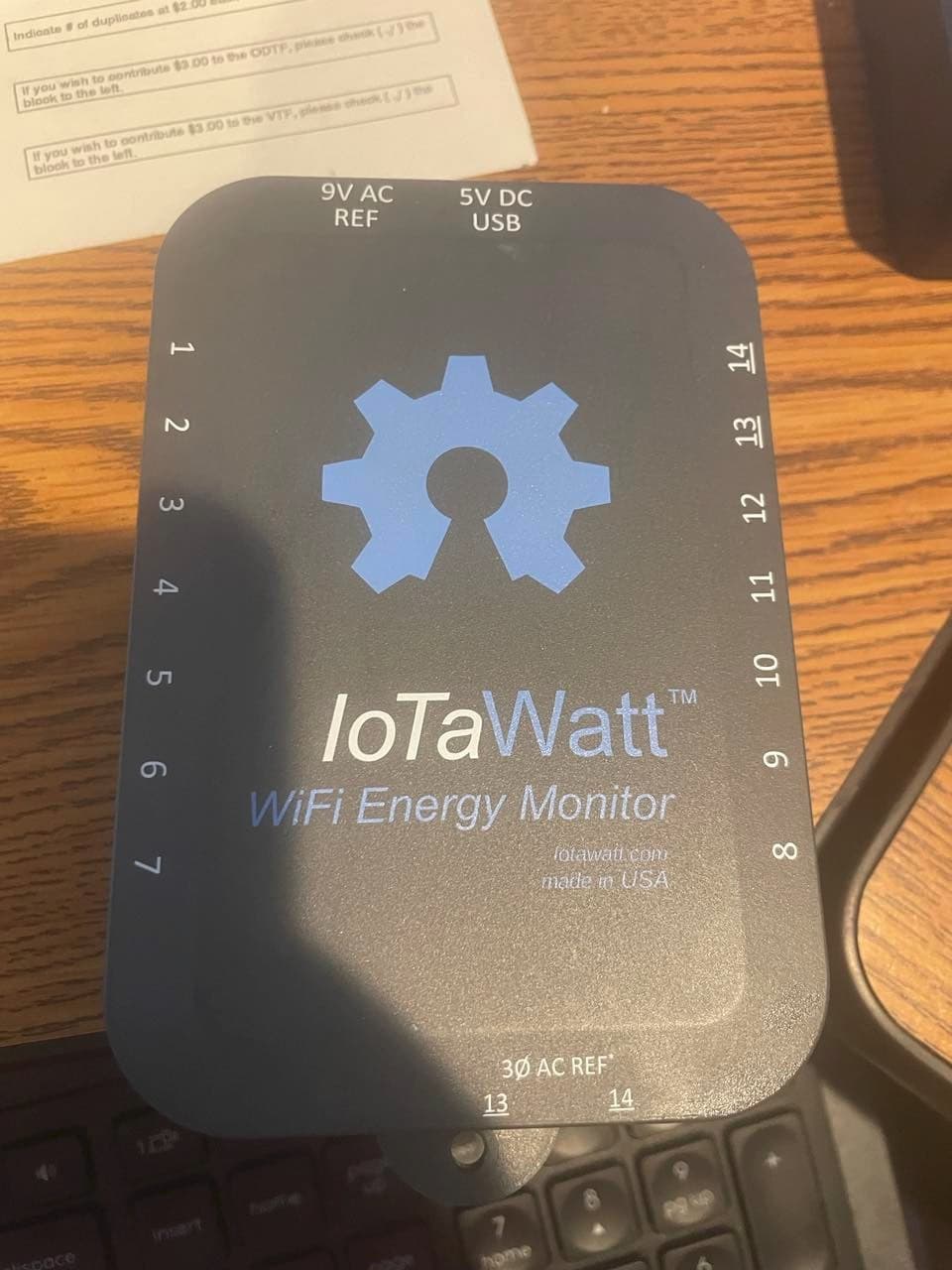

Curious as to why it requires 2 power inputs…?
One powers the unit (black one) The other is for reference power..
Interesting that they need that to be separate… I have a Aeotec and the power supply does both.
