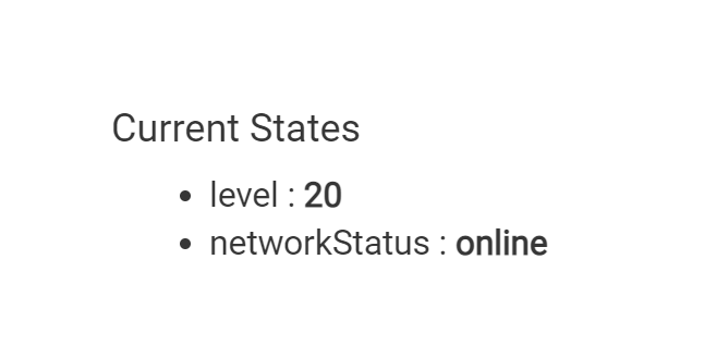

The problem with the ST19 bulb is that it only seems to be recognized/supported as a Wiz Device Stub. I've tried changing it to other different device types (Wiz Dimmer, Wiz RGBW Light, Generic Component Dimmer) but none of them make it function. Set to Device Stub, the only command it has is Refresh, which doesn't appear to do anything. Current States properly shows networkStatus as on/offline, but nothing else.

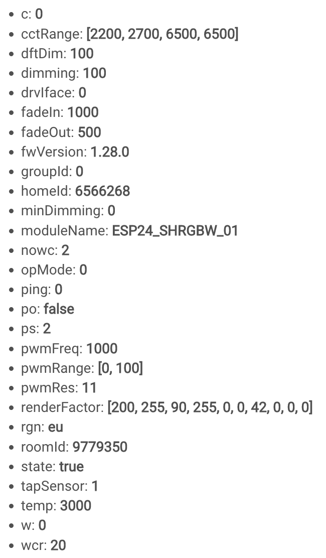

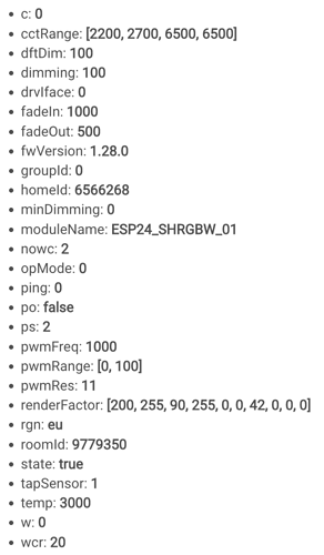

Can you post the Data section of the device details page? It should look something like this:

I took a screenshot of the device details as requested:
Device Stub

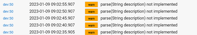

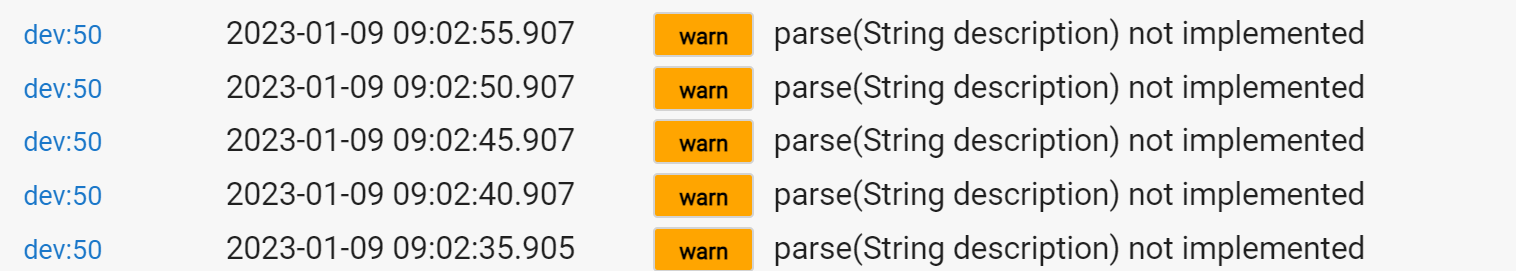

Here's the log too if that's helpful:
In the past, when I switched the type to Wiz RGBW Light and pressed commands, more info would show up but the light and values wouldn't change. I did this dozens of times in the past with the same result--no control over the light.

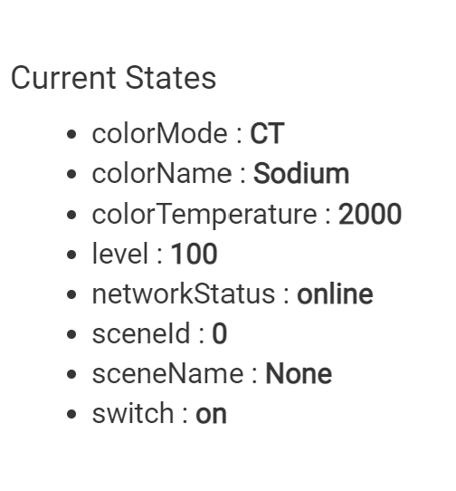

However, today, for whatever reason, after switching it to RGBW Light, hubitat is controlling the light. The logs are no longer showing anything and the device info looks like this:
