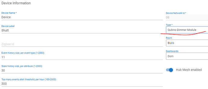

You must put that device into pairing mode like in the small manual added to the device and it can be added automatically via "Add device" in the device section - if you need detailed instructions how to go into pairing mode let me know.
After device is found you must change one setting --> Type:
Then it works but I can only operate it via Dashboard. Not directly from the Hubitat device section. Buttons there don't work.

I got it working !!!
I used the "Qubino shutter Module" driver. Did a new calibration from the device page and was able to succefully open, close, set to a specific position and feedback on the shutter status (open, closed, partially open)
